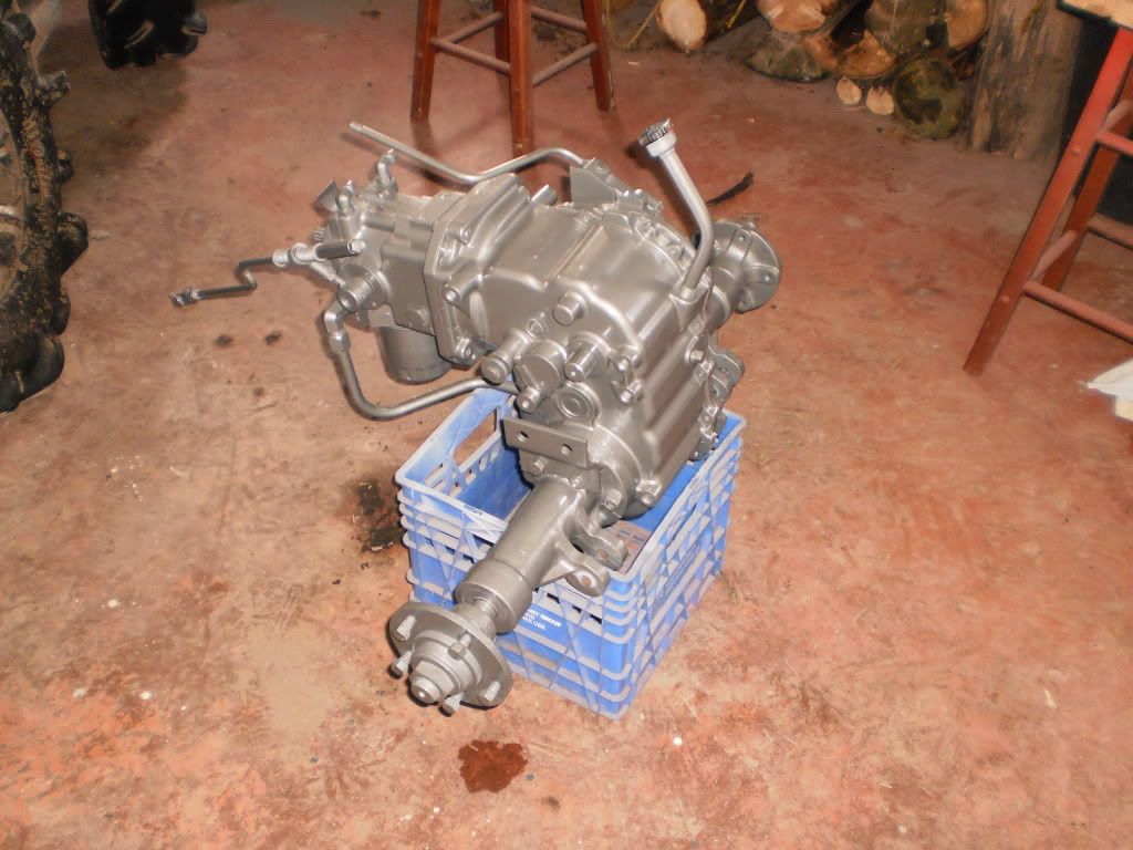

What type of hydro's do these use? Pictures would be great.
Thanks
Sundstrand model 15 "Inline" series. Can't find a pic handy. Mostly look for the obvious....leaking oil, loose/worn linkages, and extreme whining sounds from the hydro. They have some natural whine, but it shouldn't sound off real easy to hear. Slowing down a lot going uphill is a sign of hydro wear also. They will slow just a little, but not much when encountering a steep slope.

Sunstrand I beleive.

I don't know about any downsides for the MF 14/16, but the hydro/rear end is about the best available for GTs.

The rear end has been covered. Tough units. In one of my service manuals (MF1450 I think) it describes how
to test the hydro. The rear ends where the same, in many of the 1450s.
It says to rev up the engine, drive forward fast, and then throw it into reverse. You are to do this on loose
gravel. If you dig a hole, it's all good.
