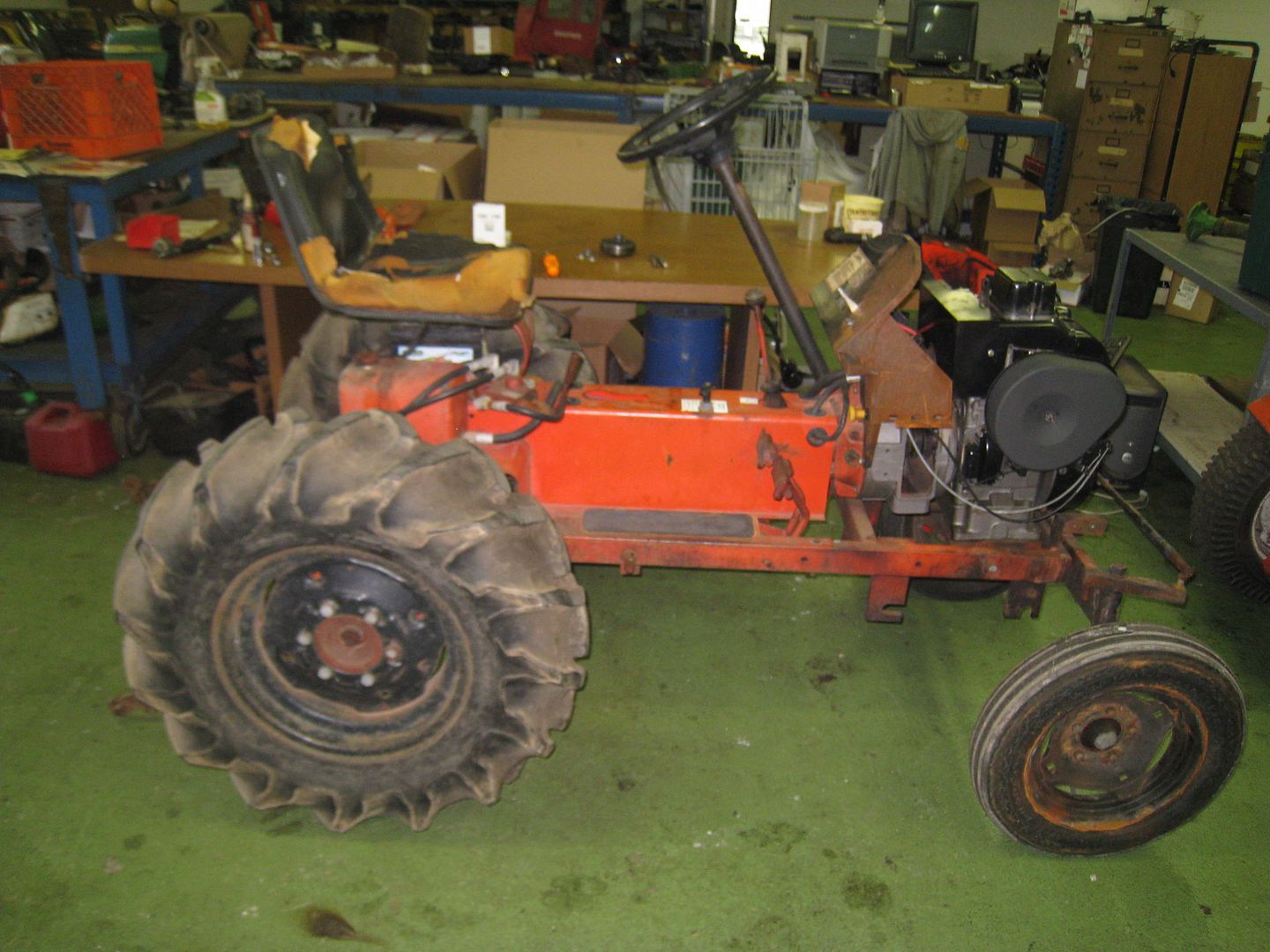

Hi, I am adding hydraulics to my power king 1614. I bought an entire hydraulic system off of a 1618.
However I was thinking of replacing the single valve with a 3 spool valve for future hydraulics. (Hydraulic angle snow plow, independent front lift for plow and independent rear lift.)
So I need to find out the gpm and psi of the power king pump. Also the valve that is there does anyone know what the relief of the valve is set at?
If someone could please help me out I would most definitely appreciate it.
Thanks,
Charles

Without loader pump is real low volume. Thinking only around 1.8 gpm or such. Pressures are low too. Thinking around 800 is all, but don't have actual specs. the PK yahoo group has that info in their files there. Later PK's did have second lever for rear implements, but was just another valve and cylinder and rockshaft put in for rear, no pump changes. These were the "Plastic Kings" I mean.

Typical hydrostatic lift circuits run anywhere from 1 1/2 to 2.5gpm, and pressures ranging from 500 to 750+psi. If you added a dedicated hydraulic pump/reservoir system, you can have all the flow & pressure you want.
It has a dedicated pump, valve, and tank, since it has a manual trans.
I was considering adding a 3 spool valve with a float function for the up and down on the blade.
So I would I have to adjust the relief on the new valve if it is preset at 2000psi if the pump only puts out like 800 psi?
I am only 20, I am very well educated in most mechaincal things, however hydraulics are new to me. So if anyone could help me out I would appreciate it.
I also considered adding a joystick valve with a power beyond.
-Charles
This is the pk I bought the hydraulic system off of:
Edited by CRE1992, October 14, 2012 - 04:07 PM.

Most likely your pump has more pressure capacity than 800psi. You still want the pressure relief set lower, as no GT needs that much pressure unless running a wood splitter. My front end loader lifts 500lbs easy with less than 750psi. Is your relief valve adjustable? Many are a preset cartridge.

Found on my thumbdrive of PK stuff ONE of the systems, from 1980, which is close to what you got off parts tractor I would think. Shows pump #23-6304 as 1.7 gmp and 9/16" shaft. Can't find stuff on pressure yet.
Found a page in repair manual section about settings. Looks like 1000lbs is the setting.

The 1977 brochure I have list 1000 psi for a PK , not sure if that's correct year for your tractor , Al
