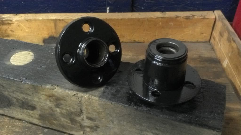

Here is the picture I promised. They are still a little tacky and I will put them into the basement tonight so they can dry better.

I forgot to put the hubs inside last night; I just brought them in now. It rained all night and is going to pour the rest of the day, I will not be able to put it back together tonight. Thats ok, the hubs are still tacky anyway. I will just put the wheels on in the morning.

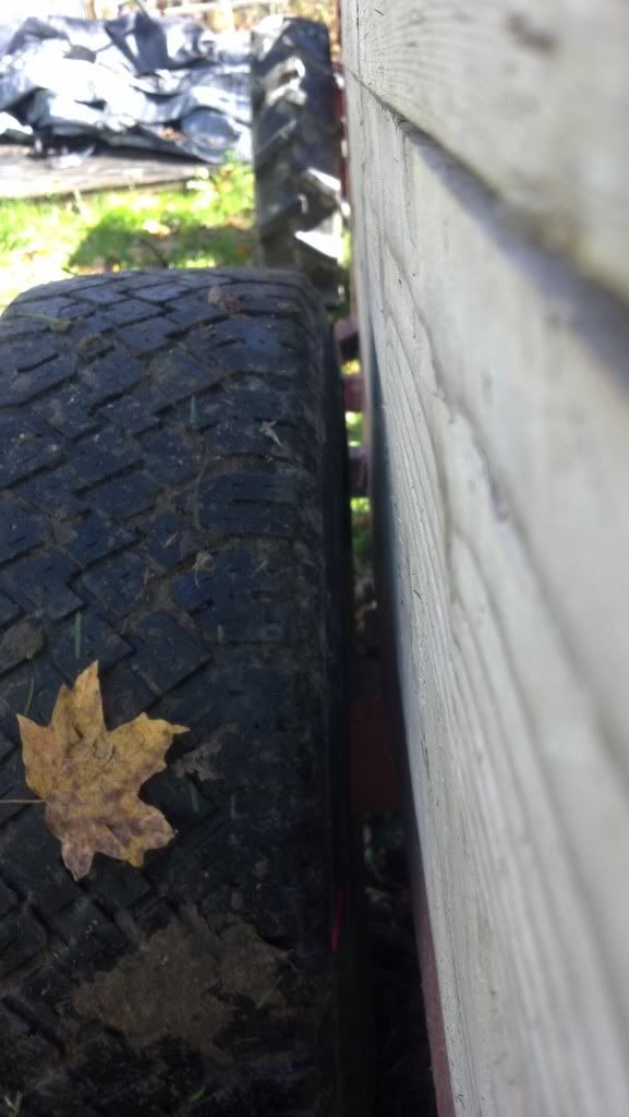

The left side tire has about and inch of clearance.

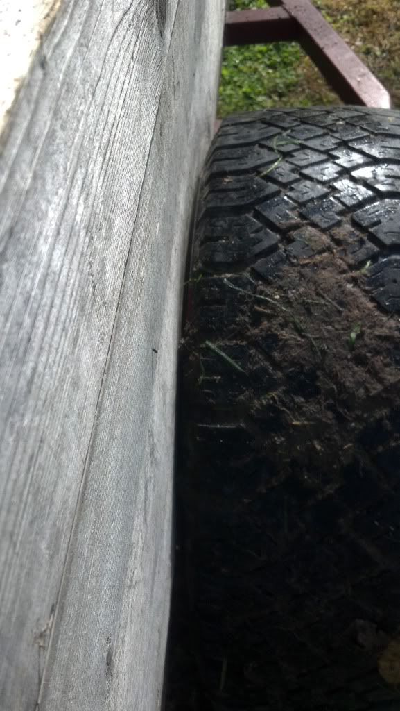

However, the right side rubs. The wood on the right side is warped and rubs on the tire a little bit.
When I built the trailer I used old recycled wood. Probably sometime in the spring I will buy wood and put new sides on it.

Ryan, Your rims turned out great. :thumbs: Your recycled wood looks to be in good shape, just take the warped piece and reverse it so that the bow is toward the inside. Might just last a lot longer than you think. One nice thing about the old wood is that it has already warped and you know which way, new wood may just give you the same problem, but on both sides! :wallbanging:

Looks great Ryan, but I would fix that warped side because if you dont you will rub thru your side wall in time. Just add a 2x4 lengthwise to stiffen the warp into a straighter line.

Bmerf, I cant just turn them around. The trailer frame is bent, and the corners are not squared up very well. The ends of the board must be cut at different angles to fit correctly.
Casey, that was a concern of mine. When the trailer is empty the tire only rubs the slightest bit, when full it does rub worse. I do not have a lot of fire wood left to get and I wont really use it in the winter. I think that it will be fine until I get wood. I will keep an eye on it.

Make some spacers for the wheels, say 1/2". That would get them away from the side boards.
