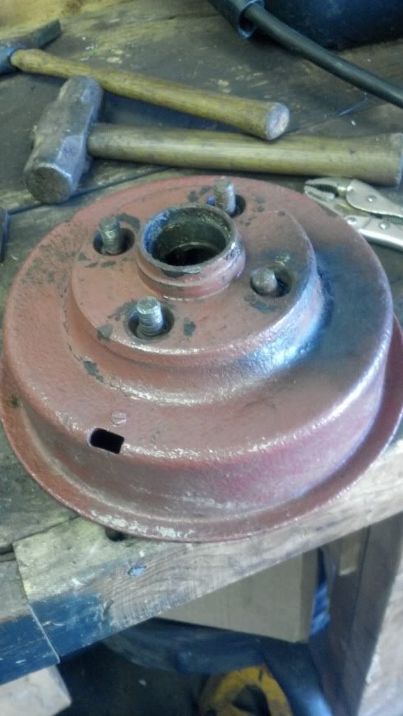

I tried to take the studs out of the hubs, but they would not come out. They did not hammer out like normal studs. It looks like they have some kind of a retaining collar on them. I gave the hubs to neighbor Dave, tomorrow he was going to see one of his friends who has a press anyway; he will be able to put the hub into the press and get the studs out that way.

Dave was not able to see the guy with the press; instead, I tried to do it a different way. I put the hub up against the frame of a F250 pickup (heaviest thing currently in my driveway), and put a bottle jack under one of the studs. These are harder to get out then I thought! I lifted up the back of the truck! I have done all I can do myself, now I need help.

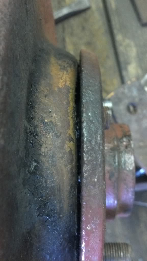

After that did not work, I tried to burn the studs out! At first I tried to cut them from the back... didn't work and I just made it worse. To make it worse, when the grease in the hub became hot it dripped all over the floor! After I tried to cut it I then decided to try and whack it a time or two; although, it looks like it that did not do much. All I did by hitting it was separate the drum and the hub.
Here you can see where they separated. With the vibration of hitting it, some slag from the cutting got in between the two.

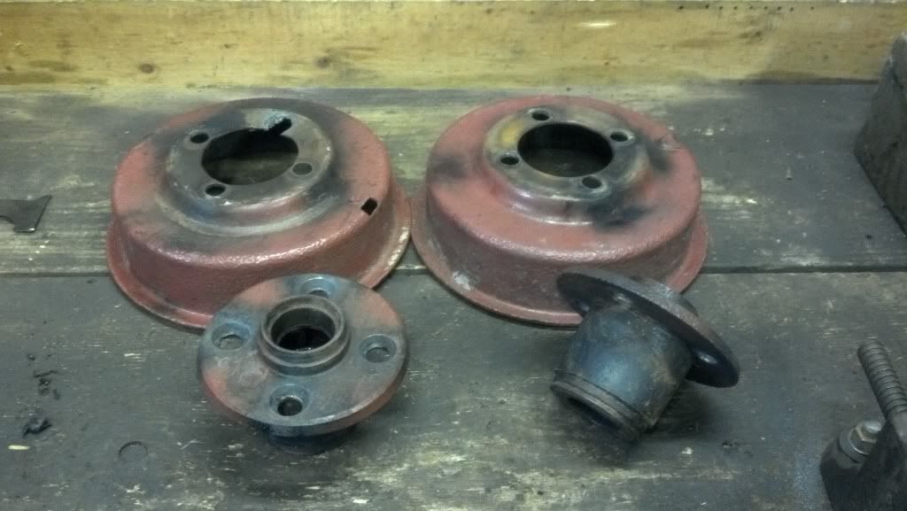

It was at this time that I called neighbor Dave to see if he could help before I made it worse. He suggested cutting the studs from the front. He thought that if the retaining washer was cut off then the stud would hammer out. And... it worked like a charm!
Really, the drum does nothing; all the drum really does is add some thickness that the studs can grab onto. I think that I can take the drum off and use just the hub. Without the drum, I believe that I can just use normal nuts and bolts to attach the wheels to the hubs. I have a few reasons for wanting to do it this way.

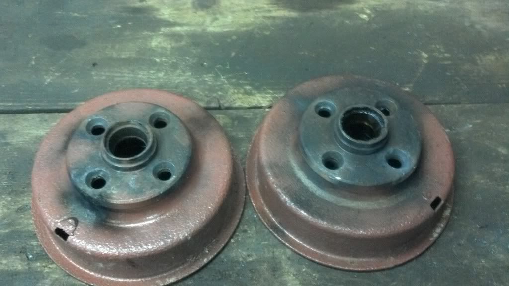

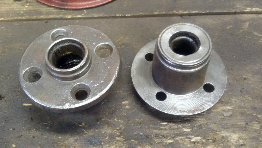

I took the hubs out of the drums; a few blocks of wood and a hammer took them right out.
I then used a wire wheel and cleaned the hubs up for paint.
I have a box of washers and a box of nuts, all I needed to attach the wheels were bolts. I just came back from getting them so I would be ready when the time comes to put it all back together.
The wheels are painted and I can mount the tires up tomorrow. I painted one side of the hubs, tomorrow I will flip them and get the other side painted up. On Friday I will be able to put the hubs and wheels back onto the trailer! I hope...
