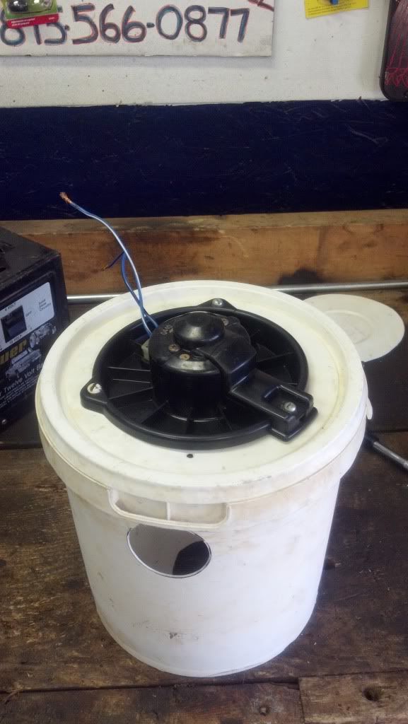

I checked the voltage when hooked up, it was 11.81 volts steady. Will this be ok to hook the charger to the fan, or should I put the fan to a battery and charge the battery?

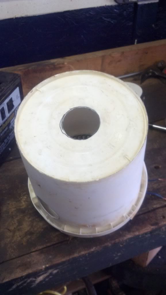

I went and got a bucket, traced and cut some holes. The fan goes into a big hole in the lid. The side hole is where everything gets blown out of and will go outside.
I put a hole in the bottom of the bucket, this will go to the exhaust vent in the side of the cabinet.
Tomorrow I will go and get some hoses.
I need to elongate the hole on the side, because the blower spins it does not blow the air straight out of the hole. Instead, it comes out at an angle, so if I put the hole on at an angle I will get more air flow.
