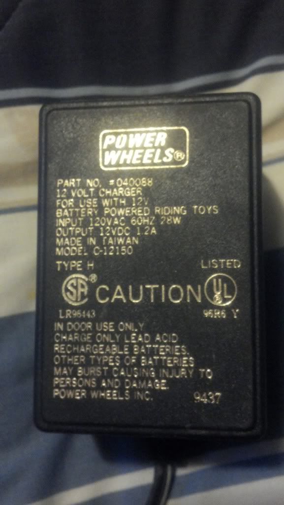

I found this one. It is a battery charger from an RC car. I looked, in the bag there where three of them. So, I will not mind cutting this one if it will work. Do you think it will work?

Ryan, if that fan is putting out a lot of air it is going to need much more than 1.2 amps. I think the best suggestion is to use a battery if you have an extra one around and just use a charger on it to keep the voltage up if you are using the cabinet for long periods of time. You could even tap into one of the tractor batteries with jumper cables but there should be a fuse or breaker in the circuit to prevent short circuits from being a fire hazard. Other wise you would need a pretty large transformer, rectifier and filter capacitor to provide 12volts DC and several amps.

That charger says that it only puts out 1.2 amps. The voltage is correct, but I don't believe the amperage will be enough. If you look close to the blower housing it may tell the amp rating of the blower. It should not hurt anything to try it, if the amperage is to low, it will turn slow. As a test it will not hurt the motor, but over time it will burn up. Hook a 12v car battery charger to it, this will supply whatever the amperage requirement is up to about 10+ amperes and not hurt anything.
