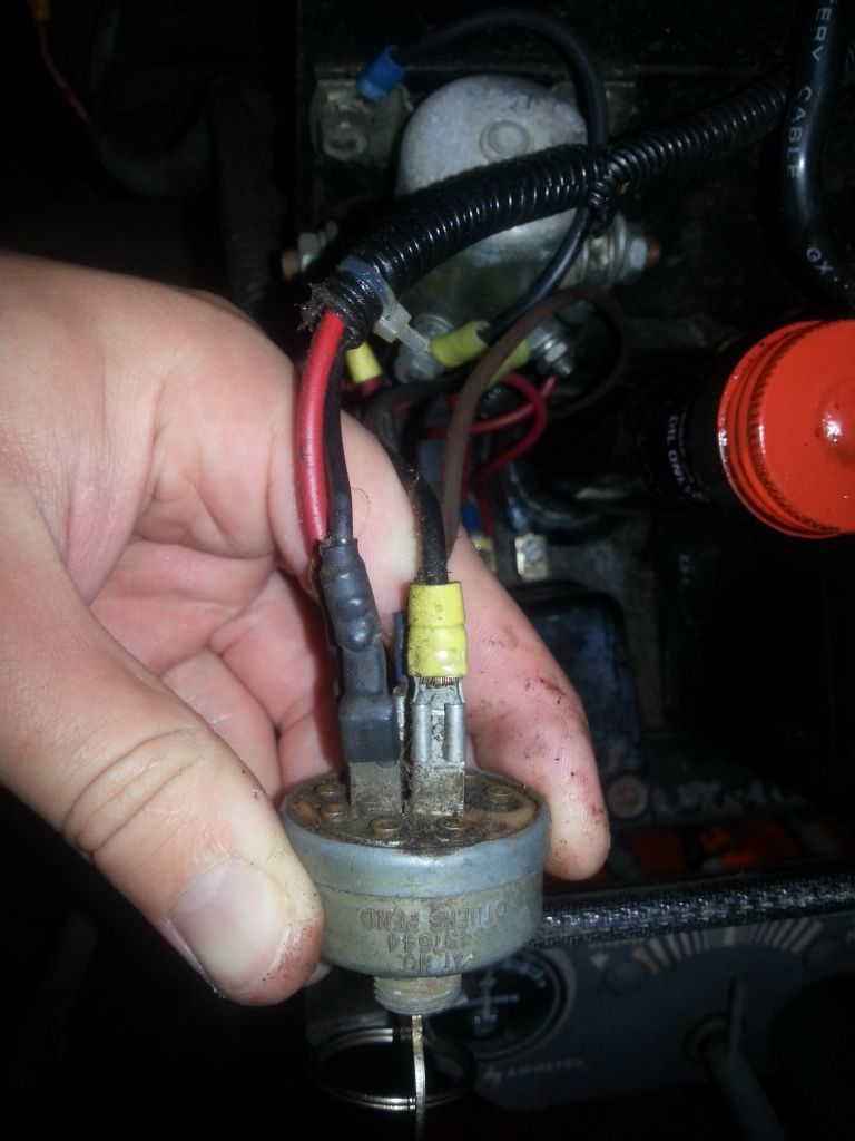

Okay mac, you were on to something. I just pulled the lights, wired brushed the paint off the corner of each light and they didn't light up BUT I then pulled the wires out of the plastic connectors and there was what appeared to be a miniature mouse's nest in there. I cleaned that out and plugged everything in and the lights lit up like a Christmas tree. THANKS A BUNCH.
So now that I've fixed the grounding issue I've discovered another problem. When the light is connected to the ignition switch (where I believe it is supposed to be connected) the lights turn on when the key is in the OFF and IGNITION positions but not in the LIGHTS position. HMMMMMMMMM! I've compared my wiring with the wiring in the manual and I believe I am wired right. That leaves the possibility that my ignition switch is turned to the incorrect orientation in the dash. Maybe this is a clue......the key comes out when it's in the LIGHTS position but will NOT come out when in the OFF position.
Thoughts?
