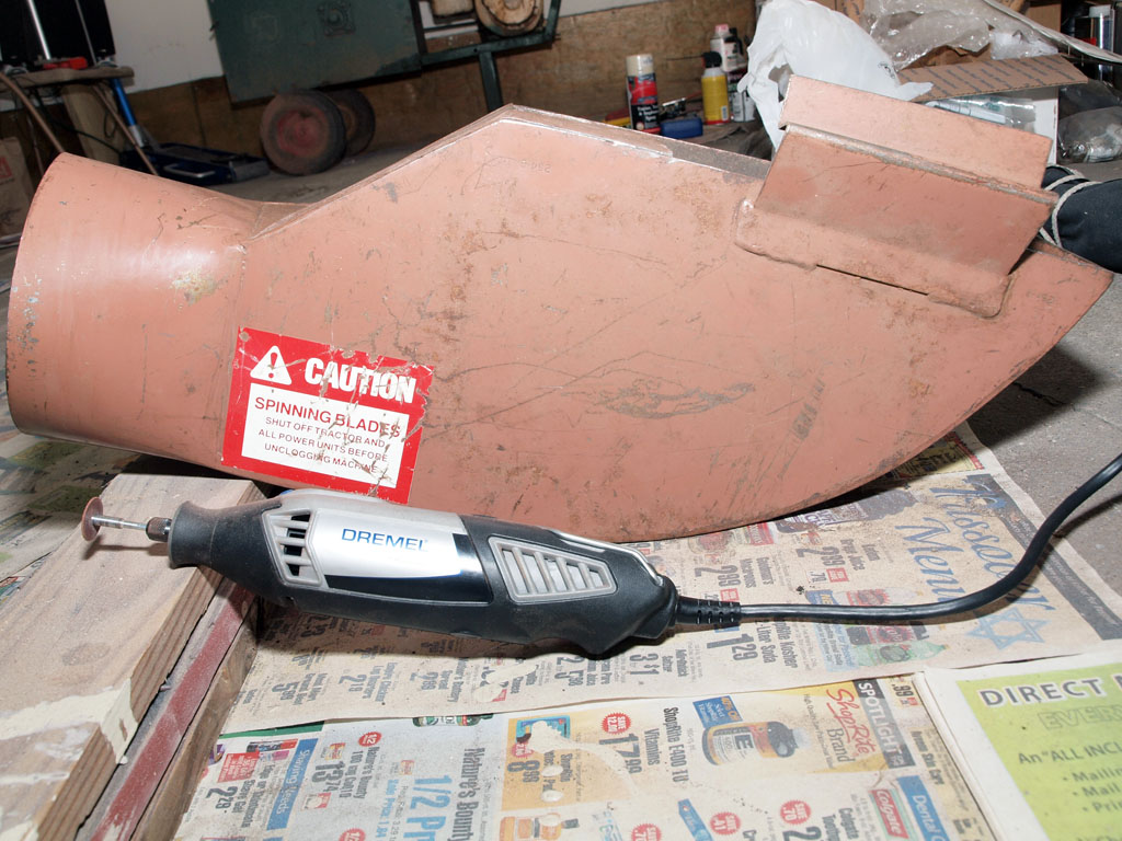

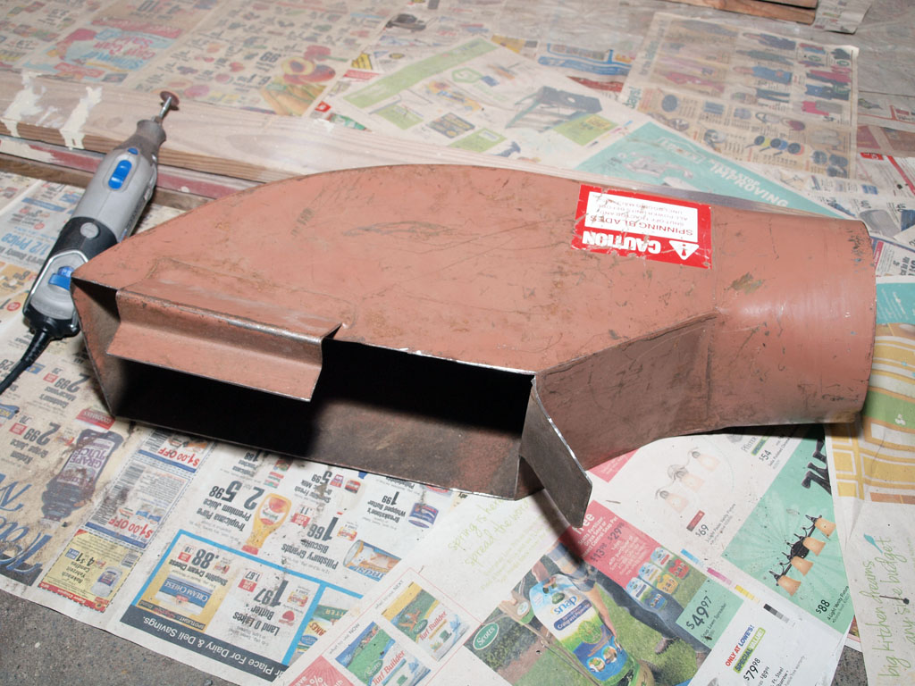

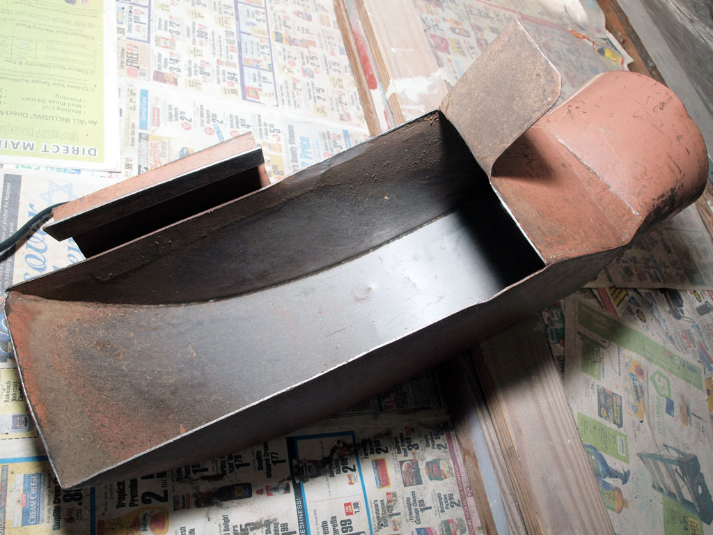

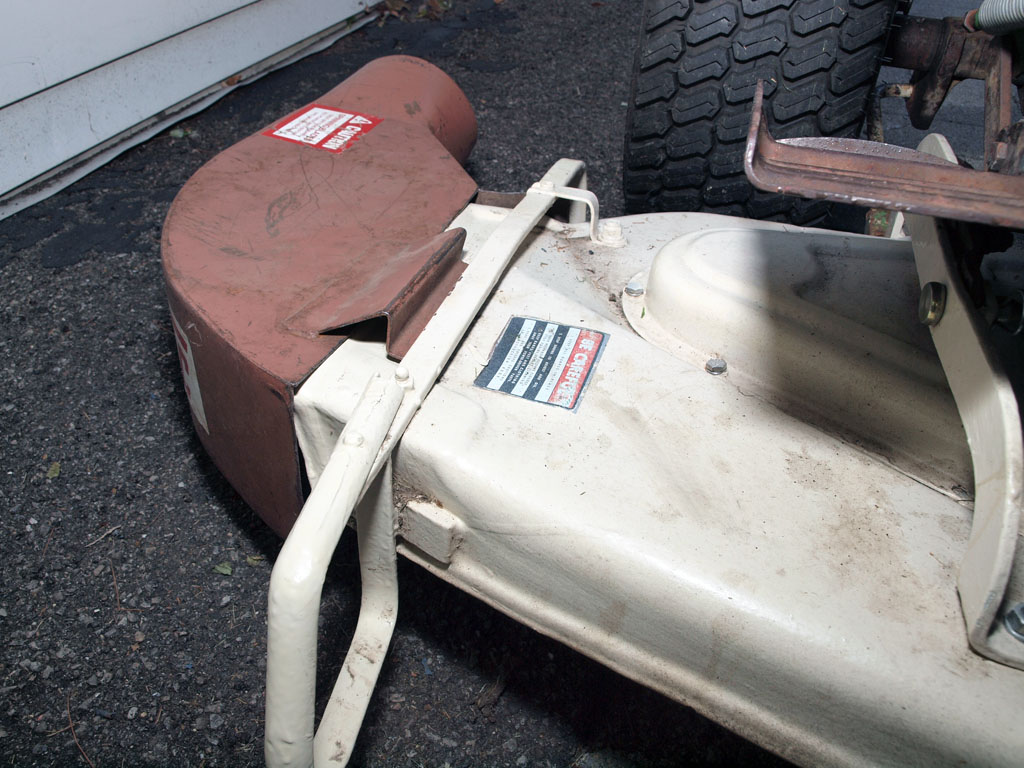

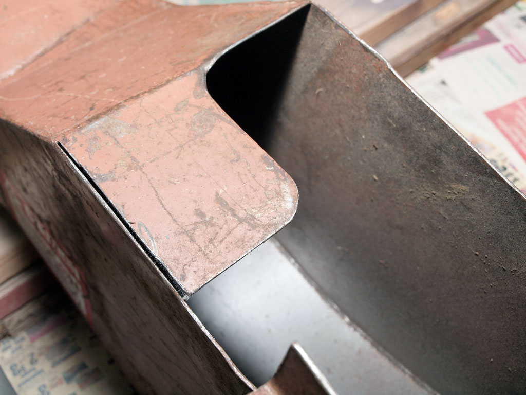

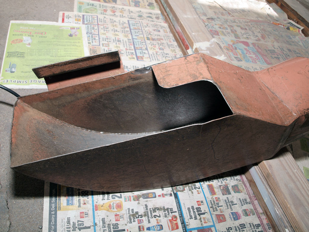

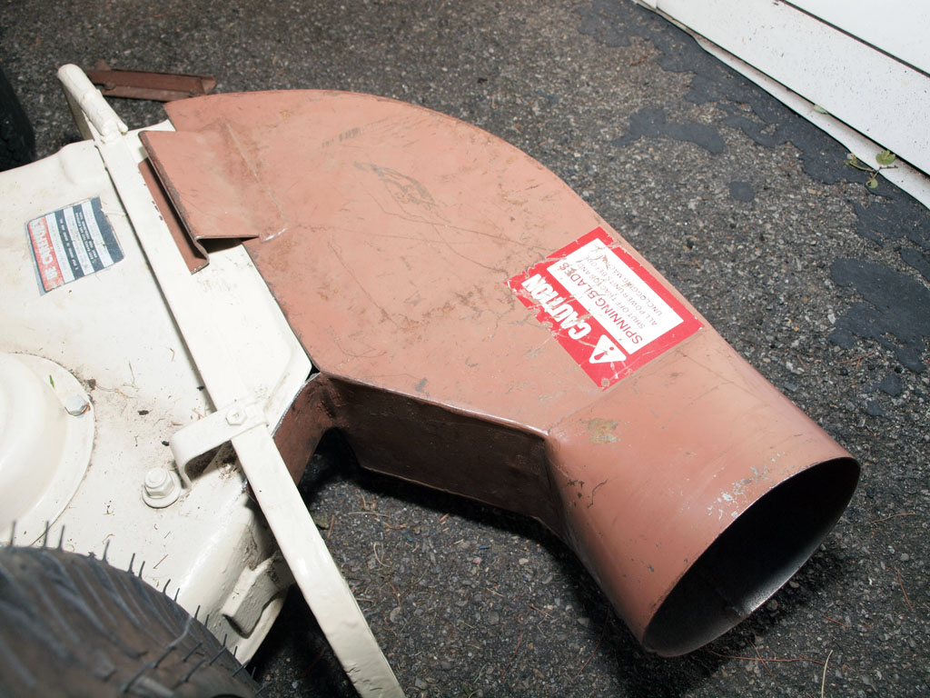

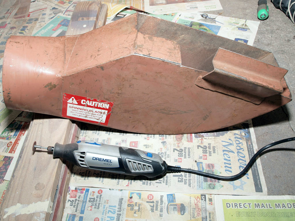

Well, I was going to update on the MacKissic, but video editing is taking a while (as usual), so thought I'd do another quick Trac-Vac update first while I'm waiting.
I had to do a little modification to the chute to get it to fit on my Bolens 850. I'm not entirely sure WHY the chute that attaches to the mower deck has a little metal flap in the way of the discharge chute of the mower deck, but I had to use my Dremel and a cutoff wheel to cut that piece so it could be bent out of the way. Here's pics of what I did to make the chute fit on my tractor:
After this, I just had to drill holes in my deck to mount the chute bracket that the chute clips into to hold the chute in place in front of the mower discharge opening. I bought some new mounting bolts to attach the bracket to my deck. Of course, I've only used this setup once before my tractor broke and now I'm side-tracked working on getting that working again. But at least the Trac-Vac should work now once my Bolens 850 is back running again.
The only issue I think I might have left is that the chute for the Trac-Vac adds some extra weight to the one side of the mower deck and I don't have any deck wheels to help balance the deck to keep it from scalping the lawn on the one side of the deck where the discharge is. Now, maybe it will be alright on flat ground, but especially on hills and uneven ground, I'm worried that this setup might scalp the lawn in spots or otherwise mow it unevenly. Does anyone have any suggestions on how to keep the tractor mowing evenly while using the Trac-Vac? Thanks!
