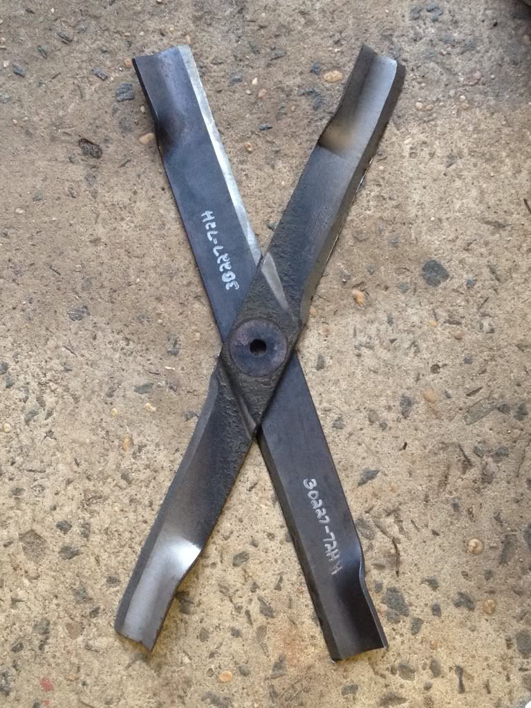

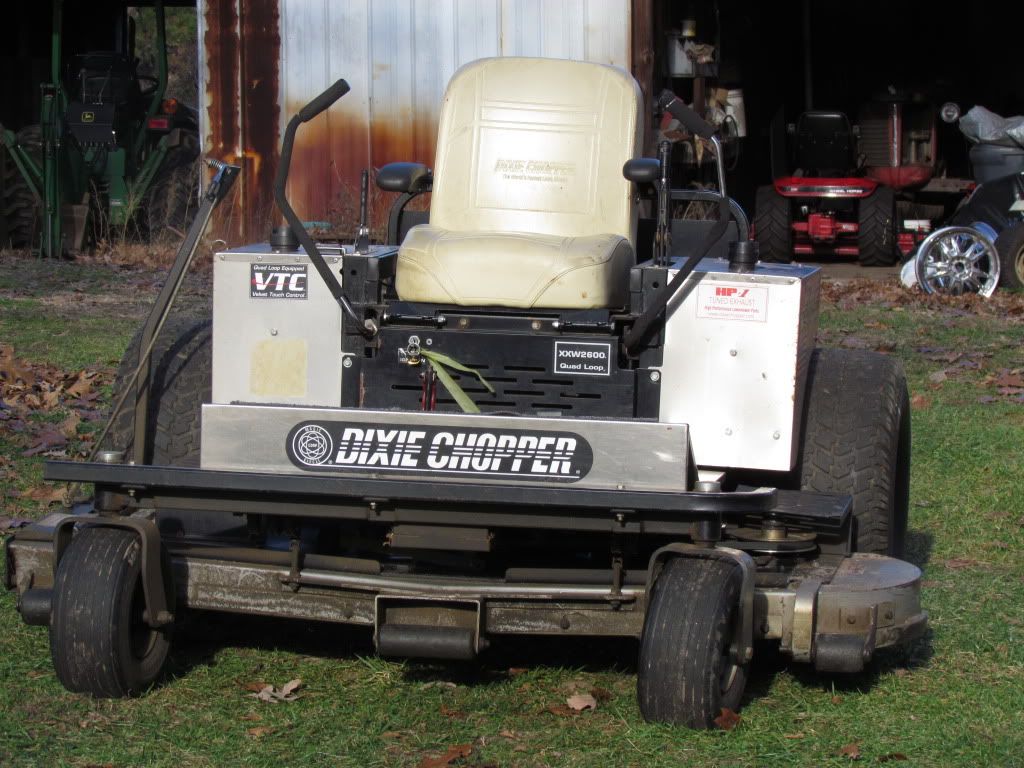

Unless the deck is a timed deck where the blades have to be perpendicular to one another, it does not matter what position the blades are in. The are supposed to spin at the same speed, so no it does not matter if they are all lined up.
I have a Dixie Chopper that I mow with, I run an X blade set up. Dixie Chopper patented this blade design with help from a good customer of theirs.
