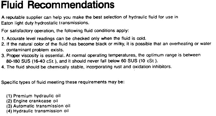

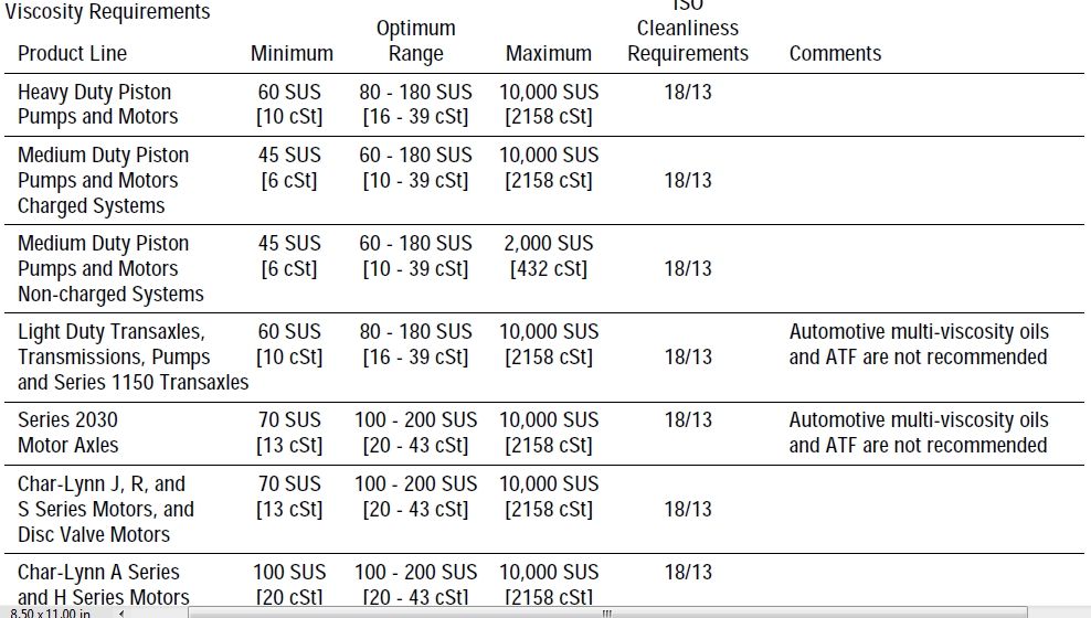

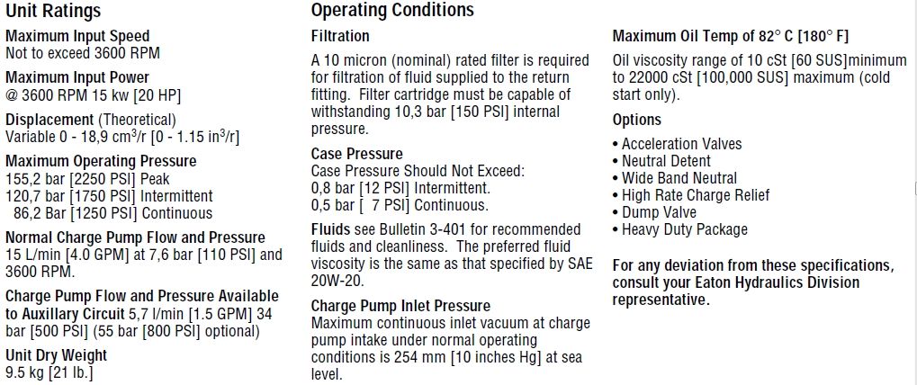

#35 CASENUT OFFLINE
  • 505 Thanks
Posted August 27, 2012 - 10:57 AM
Ok. So what does Eaton recommend? ATF or tractor hydraulic fluid? or something else?
From the Eaton PDF
Showing the Eaton 11 specs...
Showing Peak Pressure gets to 2250PSI
OK...so this says to reference Bulletin 3-401 which specifically states Against using ATF or Automotive grade lubricants...
And before seeing this I was going to use the Rotella, now ? .Flow and viscosity seem to be the ticket for this transmission but as to which lubricant to use for optimum performance.... Still studying the Sauer-Danfoss manual...
Edited by NutCASE, August 27, 2012 - 02:15 PM.
  • Russ said thank you
#36 skyrydr2 OFFLINE
  • 3,908 Thanks
  • 3,411 posts
Posted August 27, 2012 - 11:34 AM
In one of those pdfs it says 20w-20 so atf will work just fine but I prefer hy- trans transmission oil for tractors it is basically hydraulic oil with better anti foaming capabilities . On the older generation eatons you may find they will howl a bit more on atf as mine did I changed the fluid and filter to hy-trans and it got quieter but not as quietas my 165 is. And I have 2 other older Gen. 125s and they are the same . So the newer ones seem to be quieter .

#38 CASENUT OFFLINE
  • 505 Thanks
Posted August 27, 2012 - 12:52 PM
I guess my concern at this point is although the 'pump' is ok with these oils, what about the gearbox(since they don't have separate resivoirs)? I still have some diggin to do...Which this consideration could be SKYRYDR2's experience with noise...Several places in the manual they say do not mix...so that is out of the q...
Edited by NutCASE, August 27, 2012 - 12:56 PM.

#44 skyrydr2 OFFLINE
  • 3,908 Thanks
  • 3,411 posts
Posted August 28, 2012 - 03:35 AM
Hy- Trans is availible at tractor supply and even Wally world has it . The gearbox will just love that new oil too Also just cuz its red doesn't mean its atf! A lot of this oil is dyed red! For leak detection. Deere john uses red oil, Setra/Piston Bully uses it too and their version is made of veggy oil for environmental protection.
Just be sure it is a 20 w hydraulic/Transmission oil and it will work wonderful .
