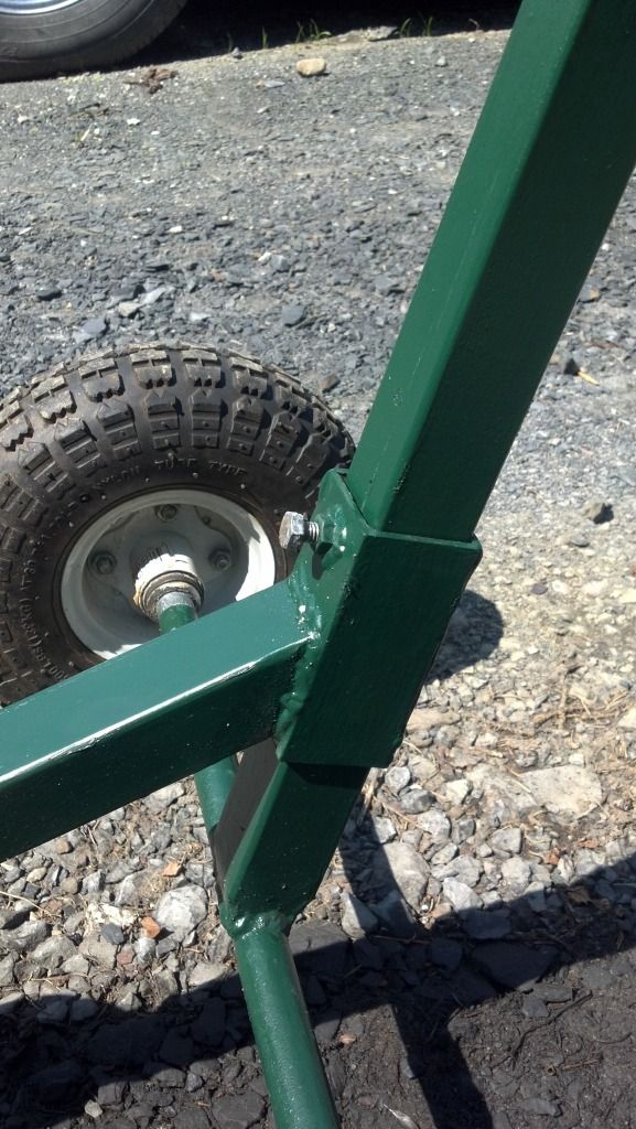

I made this little dolly so I could move the compressor around easier. It didn't take long to make, then I painted it with the same green paint as the trailer to match. If I ever get a chance I will paint the wheels black also.
I welded two pieces of angle iron into a square, drilled a hole and welded a nut over it, then put a bolt in it so it is adjustable. Just loosen the bolt and slide the arm where you want it, then tighten.

Thats a pretty neat little dolly you got there. Good idea to make it adjustable like that :thumbs: How hard do you have to push down on it to lift the compressor ?
I just put the scale on it, it is only 21 pounds before the jack stand lifts up. There is only 110 pounds of weight on the tongue anyway, not bad when the compressor is over 400 pounds! Lol!
