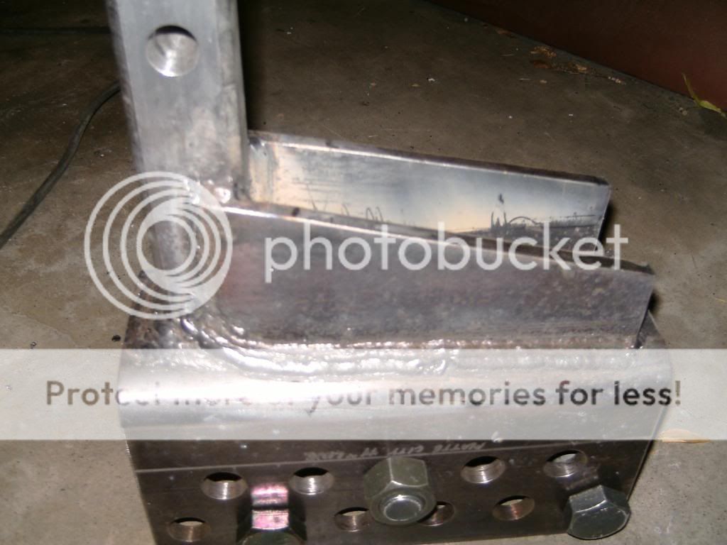

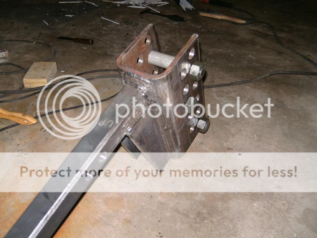

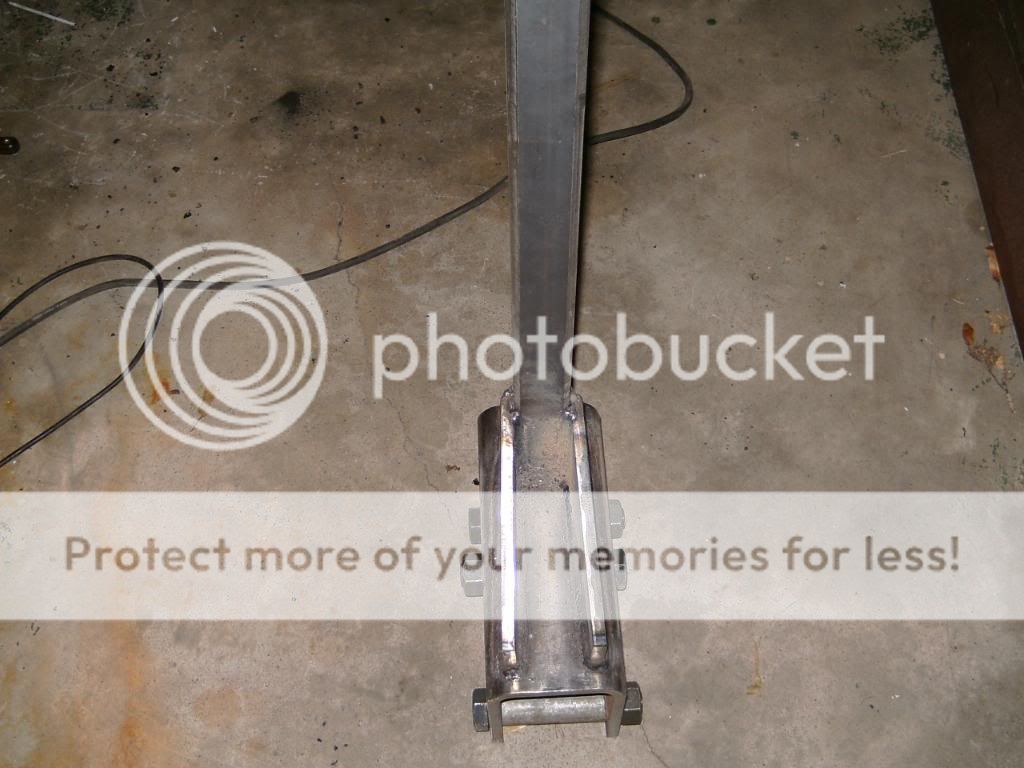

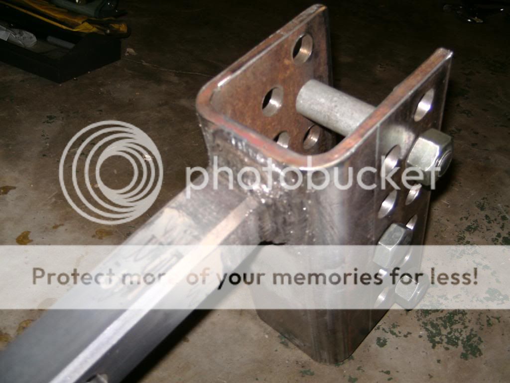

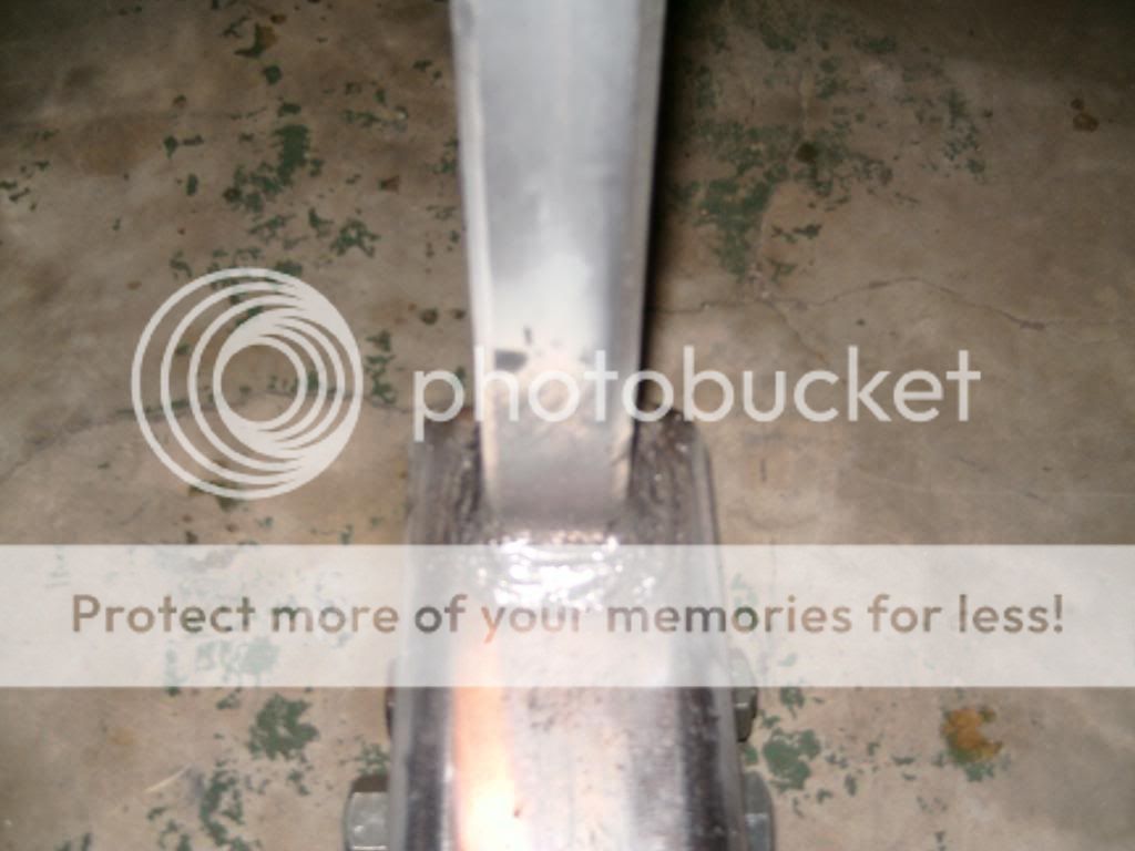

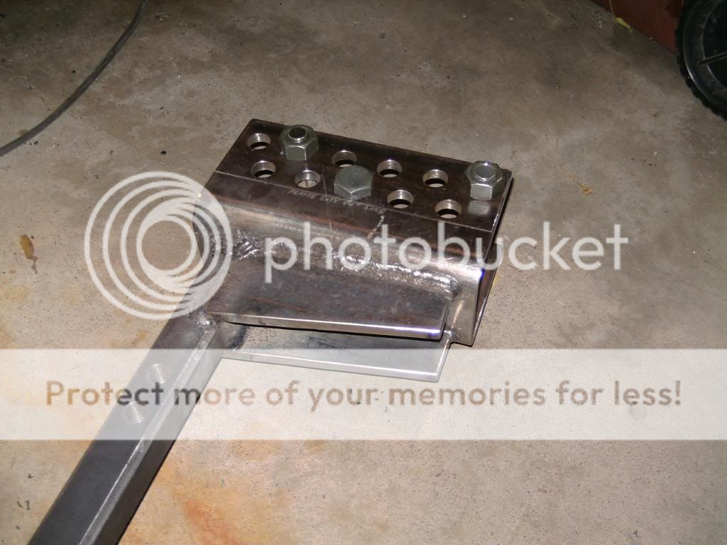

Here is what MF10 DIESEL and me have been workin on this last week.
I put about 15 passes on where the 2" bar stock meets the hitch channel because of the deep bevel I put on there. That was done with a 6011 root and 7018 cover passes. On the gussets I put down 6 passes on the out side all done with 7018.
Before Gussets
After gussets
