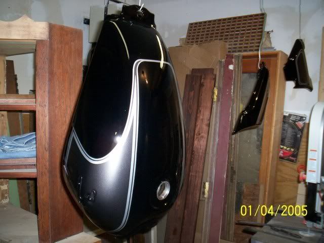

These were done using base coat/ clear coat through the gun.
Dupont Chroma Clear... VERY tough stuff and they look as good now as the day they were painted. The time stamp is wrong (cheap camera) as this was about 3-years ago.
