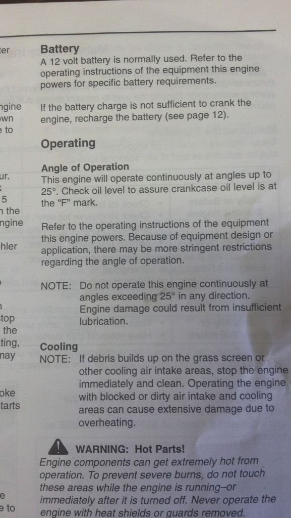

I looked at the manual, it is 25 degrees, not 30 degrees. But, it did say something about the oil there also. I took a pic of the section.

It sounds like it will still run outside of those angles. Better see if you can find a wiring diagram got it to verify, but it may not have any switch.

It may run outside those angles, but probably only if those angles flood the oil sensor with oil. The really picky position is going to be the one that tilts oil away from the sensor.
