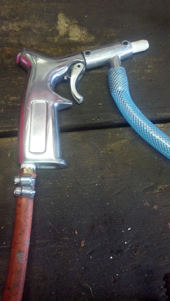

Here is the gun, it had a 3/8 coupler on it. (the media supply hose was not on all the way on here, I got it on all the way and put a clamp on it)

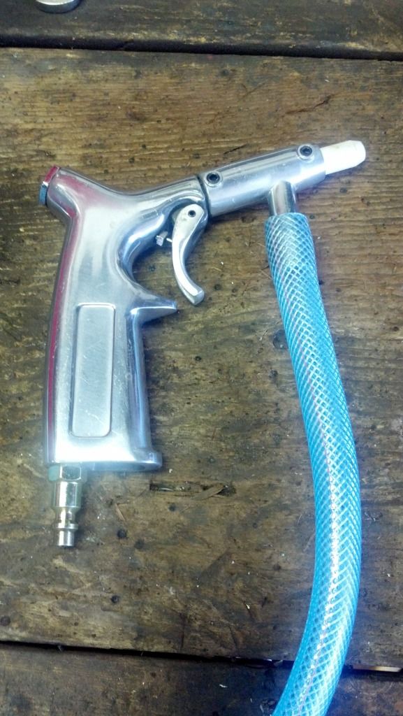

I took the quick connect off and put on a nipple.

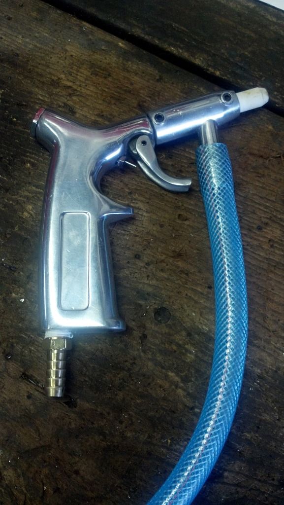

Then, I put the hose in the cabinet and clamped it on.

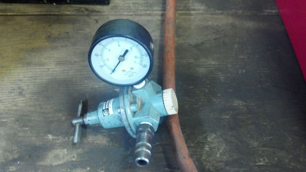

I got the regulator hooked up as much as I could. I need another nipple to attach the hose. I put a 1/2 inch coupler on the regulator and that is where I am going to hook the air supply to. I need to make the stand and find a spot for the regulator before I can cut the hose to size. Most people would have left the hose off until the stand was made so they wouldn't have the extra hose length in the way. I will have to unhook the hose from the gun so it is not in the way when I make the stand.

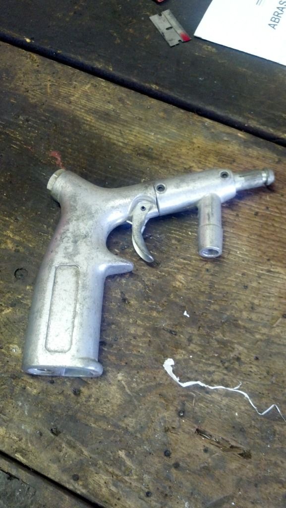

When I was looking for a coupler to put on the regulator, I found this! Another gun! The only difference is that the tip is metal not ceramic. The tips come out so that is not really a difference anyway.
