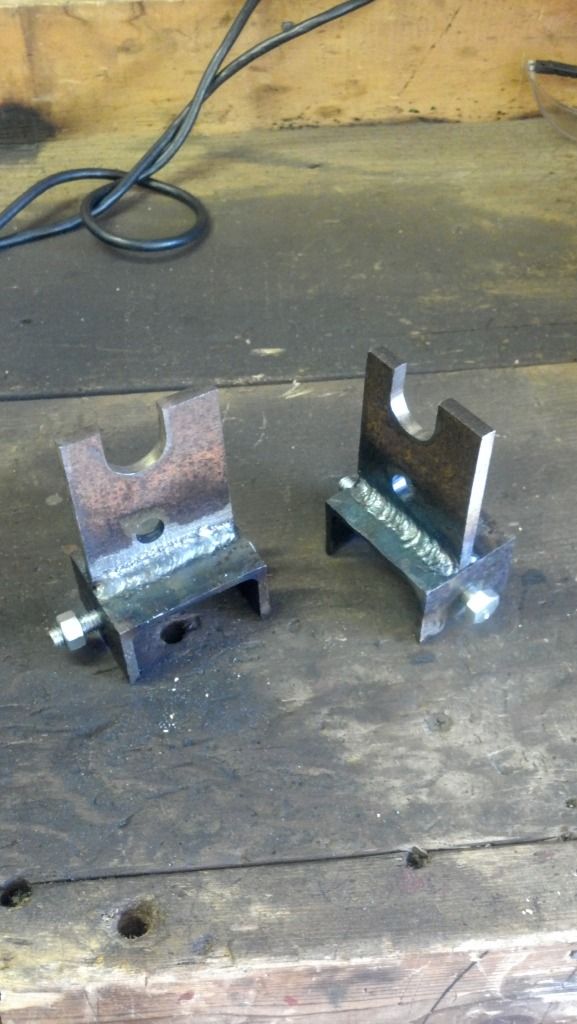

Looking great Ryan, excellent fab work. My suggestion is to make a cross brace between the blocks to draw them together a little a take up your slack a little as well as solidify them as a unit.

Was going to, but they are so solid as it is and I don't think those things will ever bend. Because they are so solid, there is no way to draw them together without heat, and if I do pull them in it will be to tight of a fit around the frame.

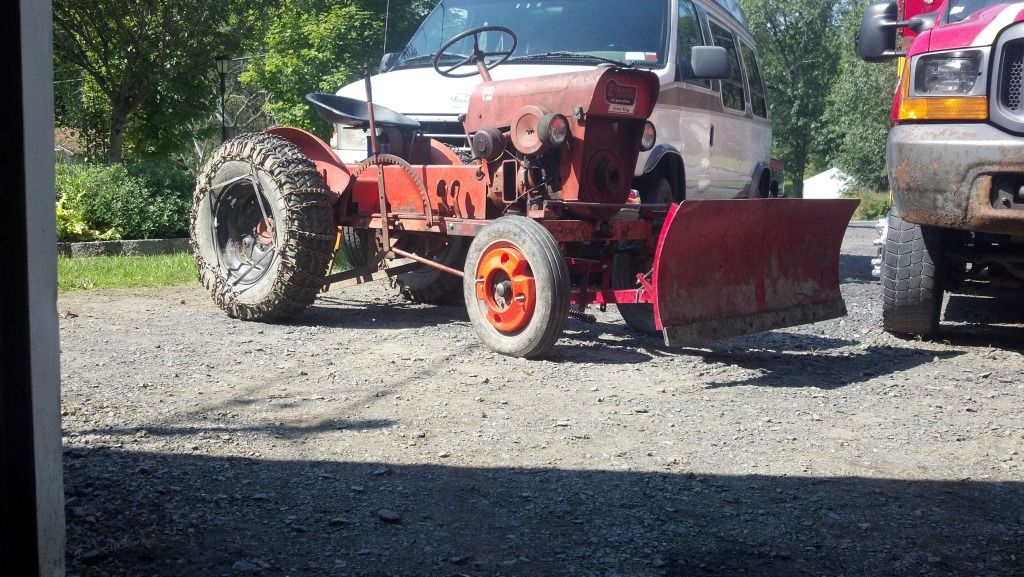

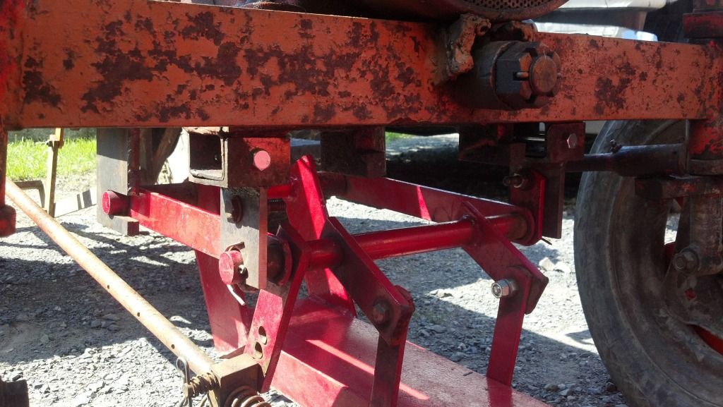

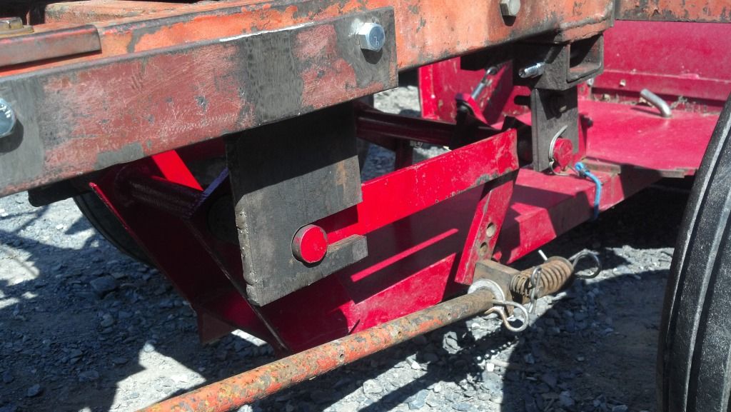

I welded up the front pieces!
I put them on and they hold the plow very well!
Lifting it is not hard, but it is not easy either, I am going to get an assist spring and hook it up to take some of the weight off.
Tomorrow I will pull them back off for paint.

This is great stuff. Be sure not to get carried away with the spring assist, because if you make it too "light", it will ride up while plowing snow. It's only the weight of the plow that keeps it down on the ground.
On the opposite side, too much weight will start removing chunks of whatever your plowing, so getting that right somewhere in between is key.

The big gear on the lift lever holds it in position, technically. I want to get a spring and set it up so that is a little less then equal so that I can keep one hand on the lift lever and "float" as I plow with it.
