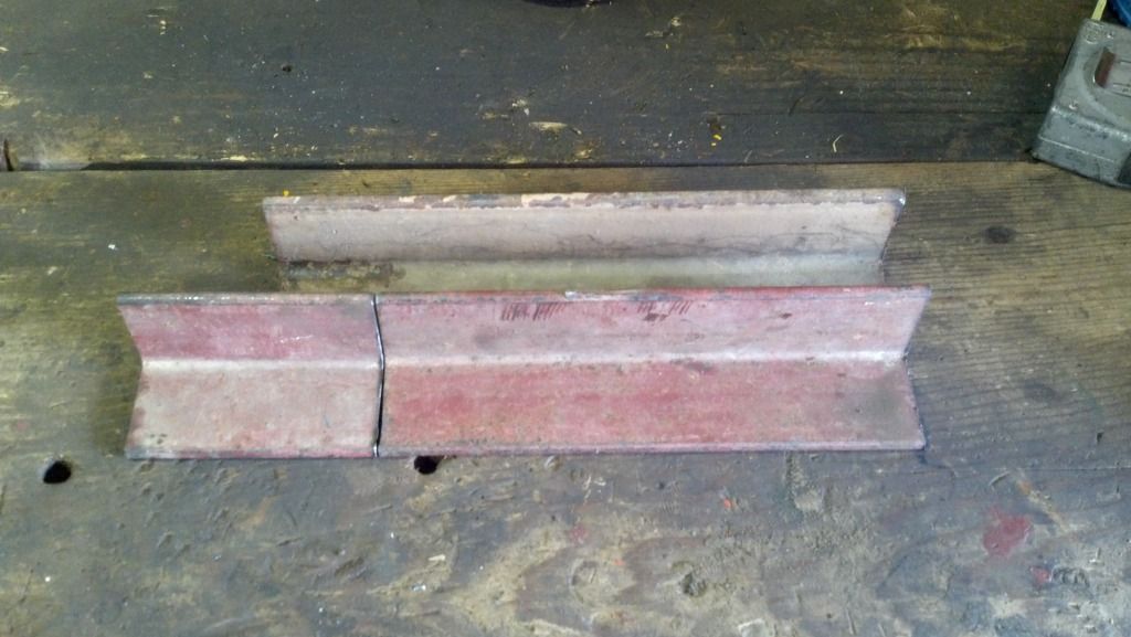

For the front blocks, I was going to bend some mower blades to go around the squares, those are for the older attachments. Originally, they used C channel for this. I got thinking and came up with a method easier then bending blades. I cut some angle iron and will weld the ends together to make the U shape. I had some steel that was the perfect height, but overlap on the bottom. I will just have to trim one edge down, weld, and grind flat.
For the rear mounting blocks I am going to weld the blocks to some angle iron that will then bolt to the frame. I measured how long the pieces had to be, and cut the first one. I went to do a test fit and I cut it at 9 inches and it needed to be 11 inches! :wallbanging: I cut the other side at the correct length after making the mistake once. When I measured the first side, my mind was of in another world and I had a lapse in concentration. I don't have another piece of angle that is that thickness and that size which is also long enough. So, I will have to weld it back together, grind it flat and recut it. :wallbanging:
The red one is the side I messed up, the tan was cut to the correct length.

Edited by Ryan313, July 26, 2012 - 12:22 PM.

I did a little bit more. The first thing I did, was "fix" my mistake from yesterday and get it recut to the proper length.
Then cut off the edges of the overlapping angle iron. They had to have 3/8" cut off and they fit around the squares. I welded them together and ground them flat.
Then, I noticed the welds on the squares were stopping my adapters from going all the way up, so I had to grind off the edges so it could fit around the welds.
They are not perfectly straight, but they will work and hold just fine! Here they are for a test fit.
I will probably end up going back out some time today to drill some holes.
