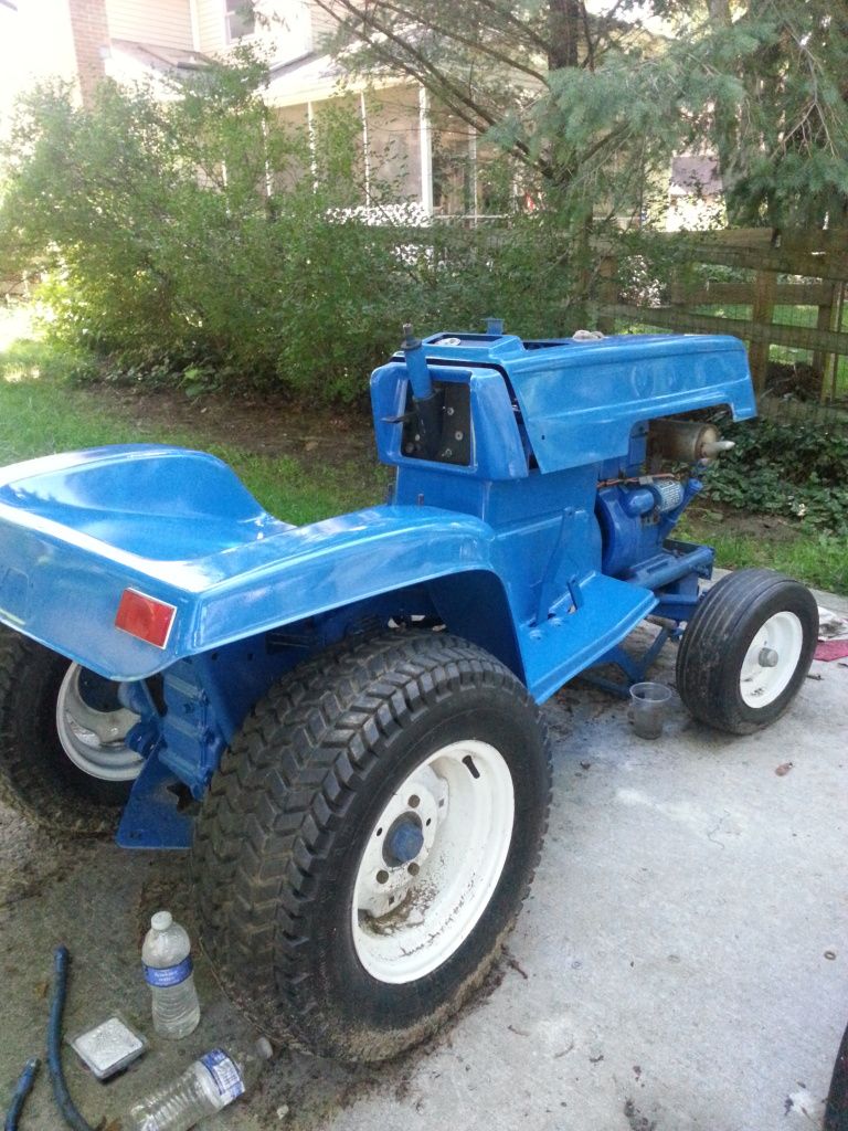

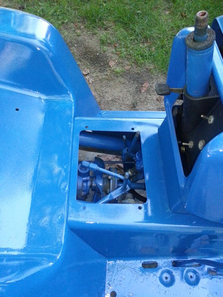

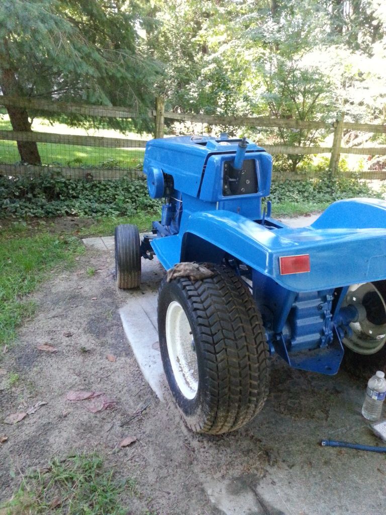

Well as promised here are some pics I shot this AM...didn't get the wheel on yet but that is a simple job, currently gettin a few more things wrapped up...
Here it is as she sits...
Anyone happen to know the 'best' way to refill the hydro system? Not really keen on starting this up without the hydro system being 'full' or at least having it when needed...Thx
Edited by NutCASE, September 10, 2012 - 01:20 PM.
Yeah, but you already have the fender pan back on. There is a vent just above the fill plug an inch or so. Take it out and use a funnel to fill till it runs out down below. Might be hard to do now.
Looks great!
