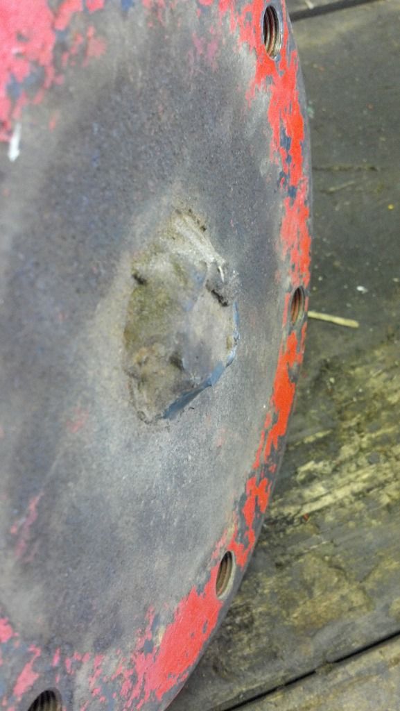

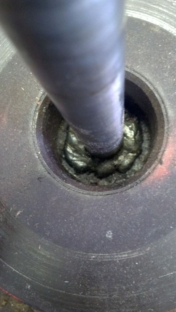

Ok, I have been talking to Steve and he has one that has a weld on it. He says it just has to be grinded down and will work fine. I trust him and I gave him the go ahead to ship it.

Where is the weld and why was it welded? If he says it good, it is.. :thumbs:

I am not exactly 100% sure where it is, if I understood correctly it is on the inside of the hub and on the outside. But, he says it will work and I trust his judgment.

The axle arrived! I saw the package sitting out front about a half hour ago. The splines look different on then ends then the OE ones. Inside the splines there are also chatter marks. I think that a PO broke the axle shaft and had a new shaft machined. Then welded into the hub. The welds are on the spots where the shaft connects with the hub, on the inside and the outside. It should work just fine.

Posted July 26, 2012 - 03:13 PM
