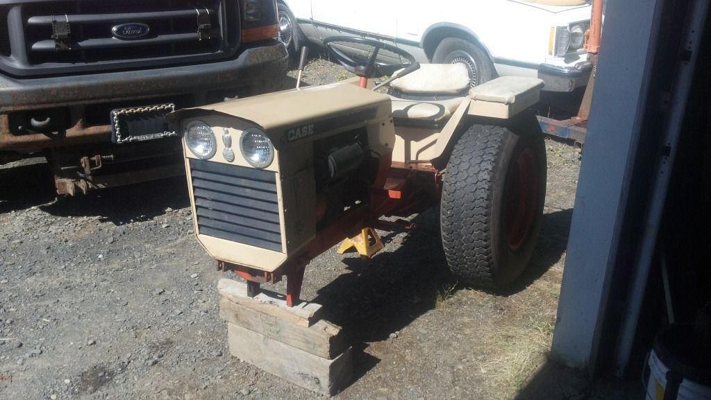

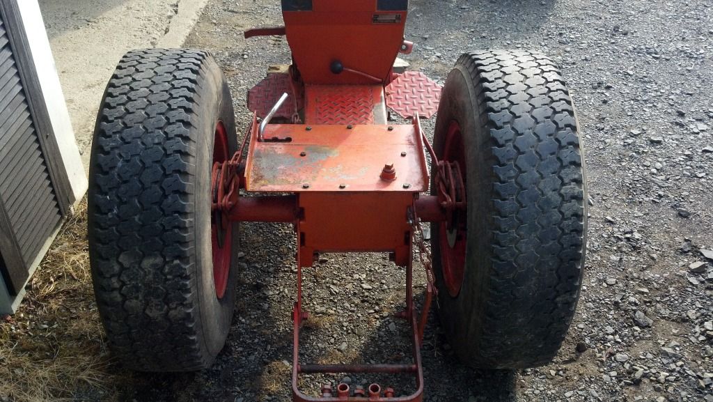

Not having the axle has been slowing me down a lot with this. Because the trans-axle is also the hydraulic reservoir I cant even try to get it running until I get that all back together and filled with fluid. Pretty much the only thing I could do was work on the front end. And since one corner is already on a stand I didn't want to take off the front axle. Well, I had enough of walking past it and I had to work on it.

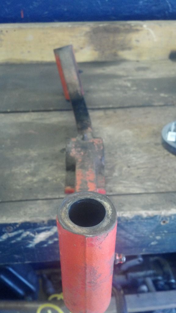

It seems like every time I really need to use the torch one of the bottles are empty! The oxygen had about 3 minutes left then it ran out. It was not enough to get the axle straightened any. I took a better pic of it, kinda blurry.

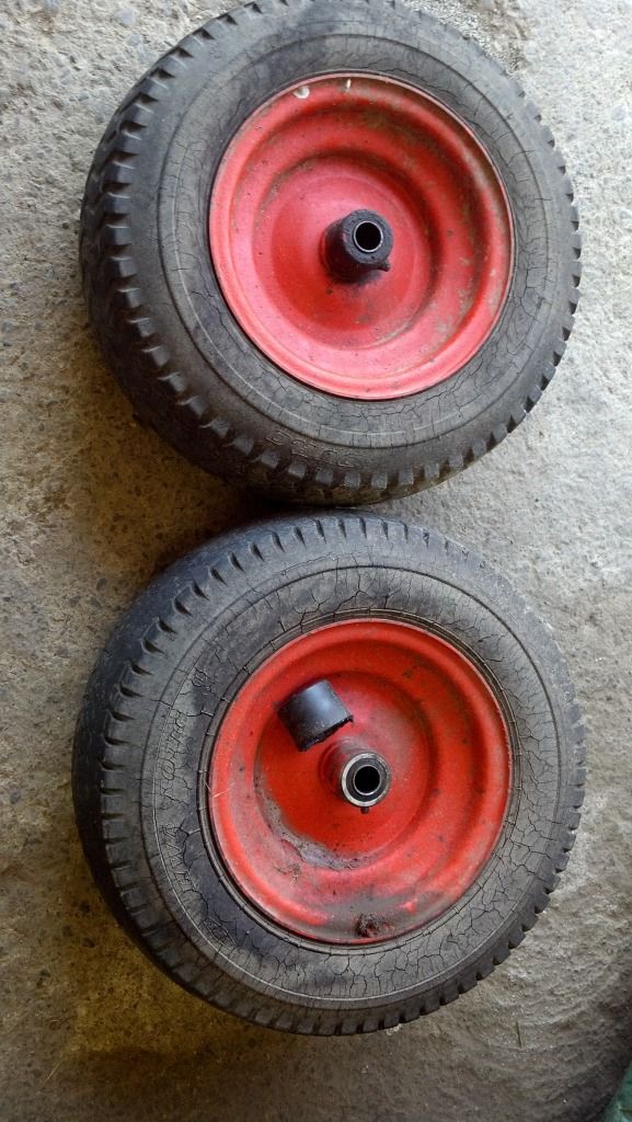

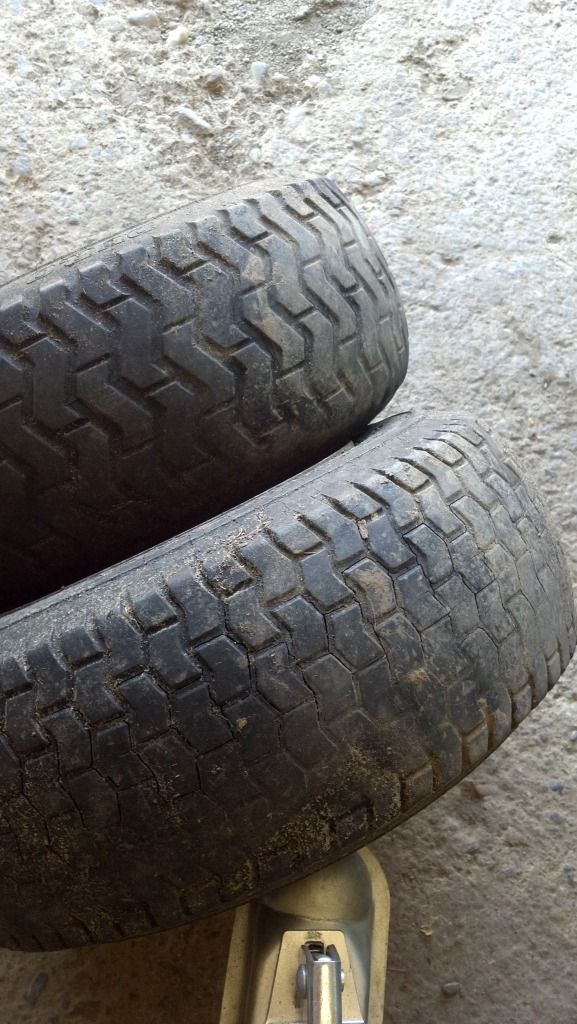

The front tires are almost bald, dry rotted away and don't even match, I have some better ones I can put on it.

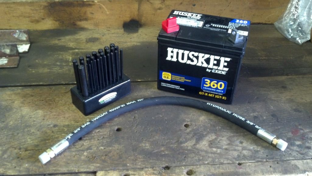

I went to TSC and HF earlier today, I got what I needed. A battery and a hydraulic hose for the 195, and some transfer punches, now I might be able to drill holes where they need to go!
