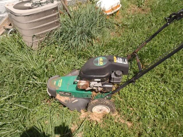

#25 UncleWillie ONLINE
  • 16,118 Thanks
  • 8,912 posts
Posted July 12, 2012 - 03:07 PM
Mine runs great
