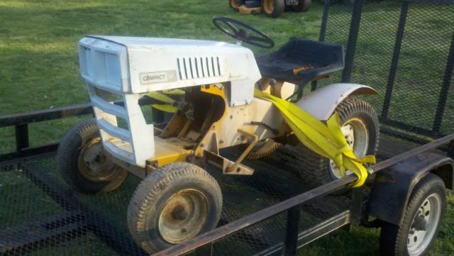

She has a 72 Sears Custom 8E

Thanks. I went to look at it for me, but as soon as she saw it she said, "You have to put an engine in it so I can drive it around." She is excited about it. Today she is going by a couple of places to look at paint colors to try and decide what she wants to paint it.

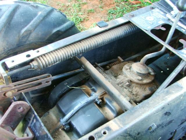

Posted July 30, 2012 - 09:00 PM

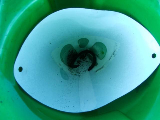

I was slightly more focused on working than taking pictures today so here is what I got. Tractor torn apart.
Crap that came out of the fuel tank.
I have an audience too
Nest right above my work area.
What I found was that the fitting on the bottom of the tank has a very fine filter sock on it. When I removed the fitting from the tank the rubber grommet tore so now I have to find one. I don't yet know if the one on the Spare frame is usable or not. Also the filter sock was destroyed. I don't really suppose I need one with a good fuel filter.

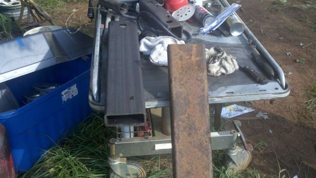

Came home and set up an electrolysis tank using a 35 gallon trash can, some old huge angle, and the battery charger hooked to a battery to keep it running. Put my bumper pieces in to see how it would work. I will fill you in tomorrow.

Here is one piece I tanked last night, Scroll up to the bumper pics for the before. The other piece needed a little more tank time.
Scraped it with a putty knife then hit it with a piece of sand paper.

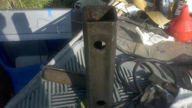

Working real good. Here is a before and after. These were one piece of steel a couple of days ago
