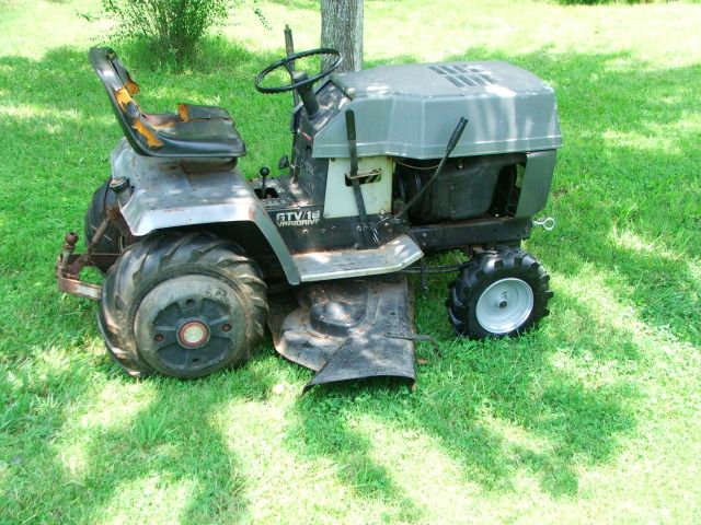

Next I will start collecting parts to rebuild the deck. Yes my restoration is bass- ackwards but so am I. I have to have one running mower so I cant take this one completely apart till I get another one cutting.
Here are the after photos from today. Got the wheels mounted. Ain"t they sexxy.. A neighbor stopped by and said didn't know they sold tractors with tires like that. I laughed. I wish I knew what the fronts came off of. I bought them from a guy on CL for $30.

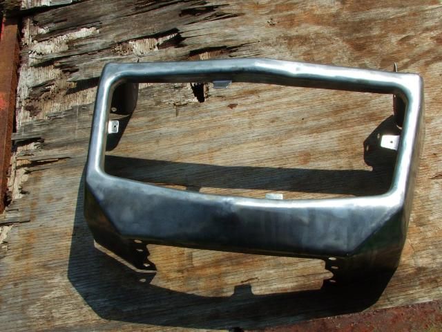

Glad to hear it is working okay! If you want a decent lens for that head light, send me a PM. It might need a bit of polishing, but it's not broken.
  • UncleWillie said thank you
#23 UncleWillie OFFLINE
  • 15,539 Thanks
  • 8,711 posts
Posted July 24, 2012 - 05:07 PM
I am considering cutting it out and putting square sealed beam lights in there. Haven't decided yet.

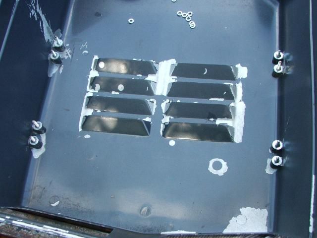

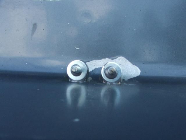

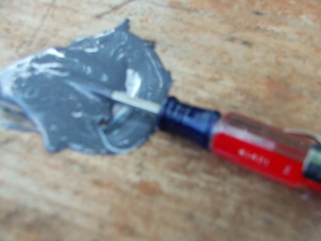

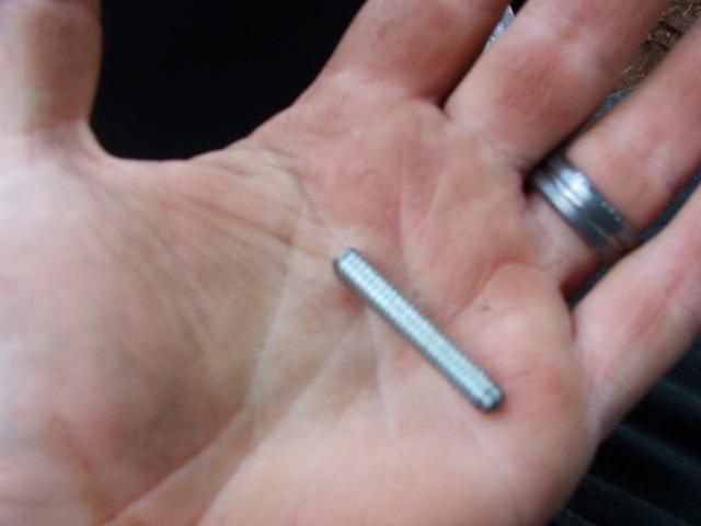

OK so to fix the hood I started by Drilling out the holes in the hood slightly larger than 1/4 inch. Don't remember exactly what size I used, but I was careful not to drill completely through the hood like the PO did. Then I took a 1/4-20 threaded rod and cutting it to about 1 1/2 inch sections.
Then I took the tractor mechanics best friend - JBWeld
And put them in. I put washers on top to add just a little bit more strength.
Did all 8

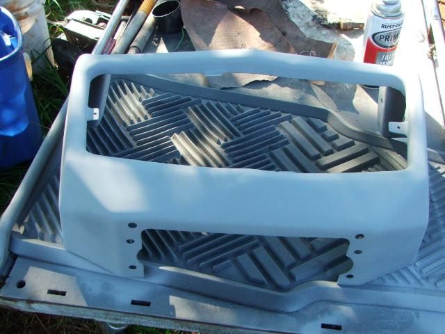

Then I took the grill off and tapped out a couple of gruesome dents where the PO drove by braille. Then my wire wheel went nuts.
Then I shot it with high fill primer

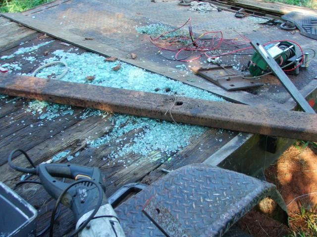

Then I dragged this monster out of the weeds.
And whittled it down with my pocket knife.

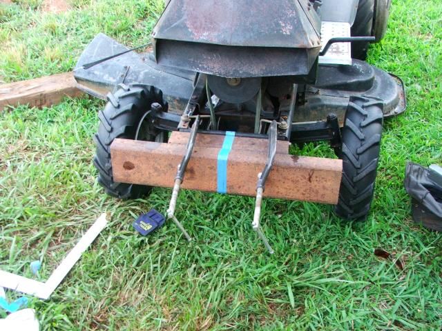

And started on a bumper.
