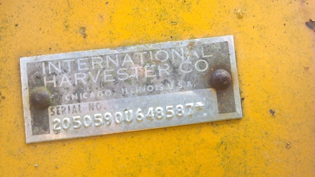

  • Location: Champlain ny
Posted July 04, 2012 - 09:47 PM

That serial number makes that tractor the 200th tractor made in March of 79.
How do you read that lol

The first three digits are the "kind code" designating what type of machine it is, 205 being a garden tractor. The next 4 digits are the "machine code", in this case 0590 designates it as a model 1100. The "U" designates it as made in the united states. Finally the numbers after the "U" are the actual serial number. Since the first number for march of 79 was 648387, your tractor 648587 is the 200th tractor from march of 79. That number includes ALL cub cadets made as there was no break in the numbers for each different model and they just gave sequential numbers to the various models in order as they came down the production line.

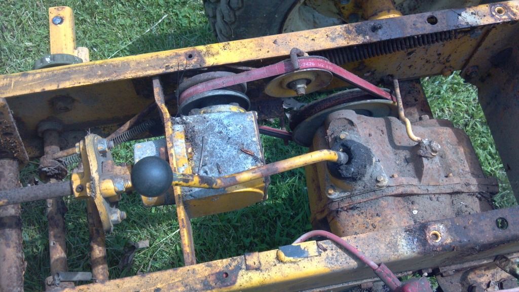

I was wondering how it could be belt drive with the motor sitting in the frame like that, but I see it has a shaft to a 90 degree gearbox with a belt to the rear. I've never seen one of these up close. Pretty interesting. Thanks for the pictures.
more pics to come as i rebuild
so i found out today the spare frame i had i cant use because it is different(129 frame is different from an 1100) so i will have to repair the 1100 frame

Better pic of the tranny and gear box

Posted July 05, 2012 - 02:02 PM
Cleaned the tranny for some paint ;)

Interesting Cub, never knew they used a BGB to do this, would've been easier to just turn the engine & use a belt from the get-go?
