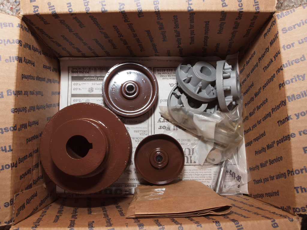

In any event, I got parts in the mail on Friday when I came home from work!!!
Ooooh... and all nice and freshly painted too!!! I even got a new ignition switch and key too that he happened to still have lying around!

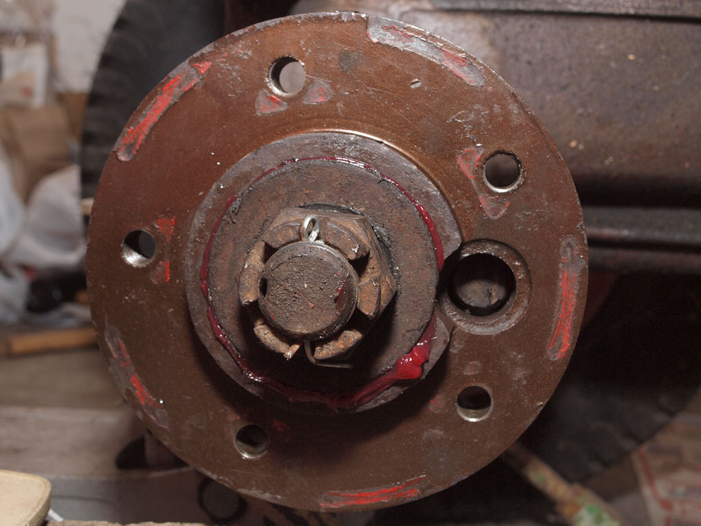

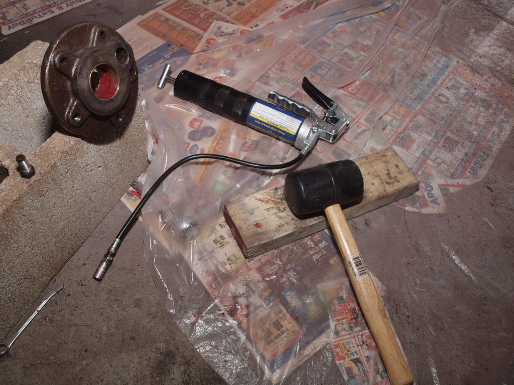

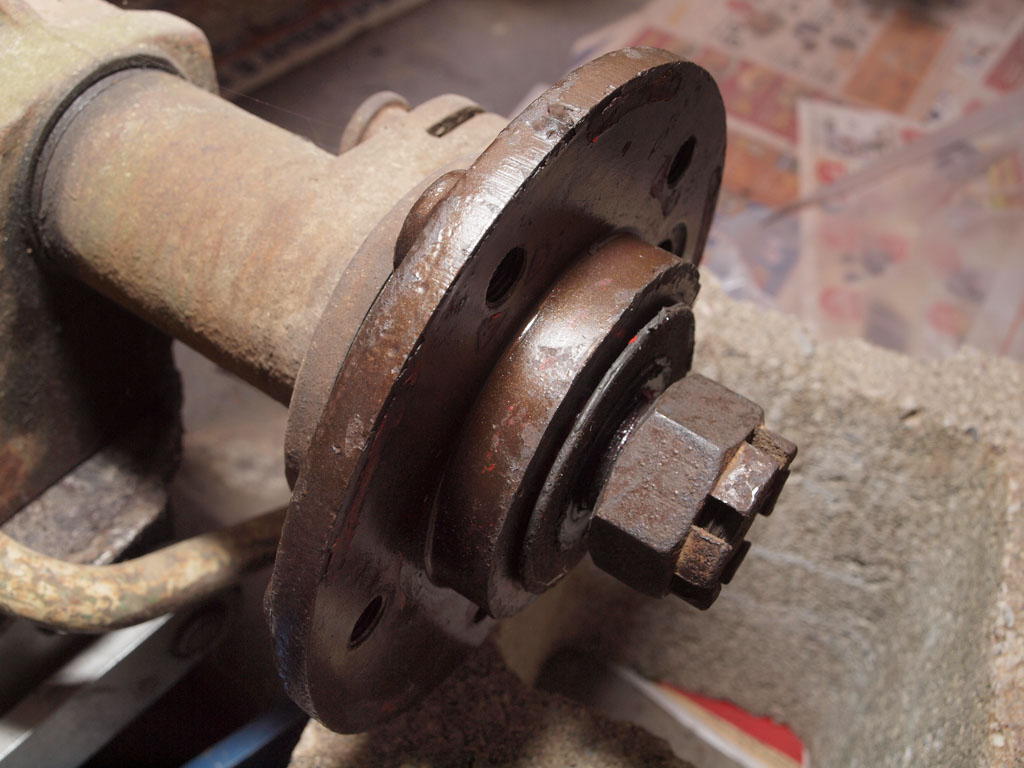

I also managed to get the other bronze bearing installed in the free-wheeling rear hub and got the hub installed on the axle. Once the wheels are done, they can be reinstalled. I greased the hub before I put it on. I'm assuming it is supposed to be greased (there was old grease in the hub when I pulled it off), but I also don't see any grease fittings in the rear end to grease it. Do you just pack it with grease the best you can when you install it and that's all that it gets? Seems like a poor design to me... But I also assume the bronze bearing takes all the wear rather than the axle or hub assembly and you just throw new ones on periodically.
I might post a quick step-by-step instruction for how I installed mine if there is demand for it. I took a bunch of photos of the install. Here is the finished product though:
(Notice the extra grease pushing out from around the flat washer after install.) The two bronze bearings press into the hub from each end and leave a small gap in between for extra grease to be held to help lubricate the hub and bearings. (Of course, I "hammered" mine in since I don't have a press and it seemed to work well without damaging them... I used a rubber mallet and a block of wood cut from a 2x4 to help cushion it when driving the bearing in to prevent damage.) Here's a photo of the tools I used:

Its always good to grease up the axle and parts when you have it apart. On the older Models they actually had a grease fitting on the hub. I dont know why Bolens did away with it though.

Yes, Tom sandblasted and painted the parts for me before he shipped them. I think that might be part of the problem with installing that engine pulley though and I'm working on sanding out the inside of the pulley now so hopefully it will install easily! I'm using some 3M Medium-Coarse sanding pads to stick inside the pulley and try to clean out any paint residue. I didn't get a new shaft key though either, so hopefully the old one that I filed down square again will work!
