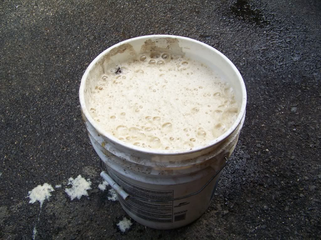

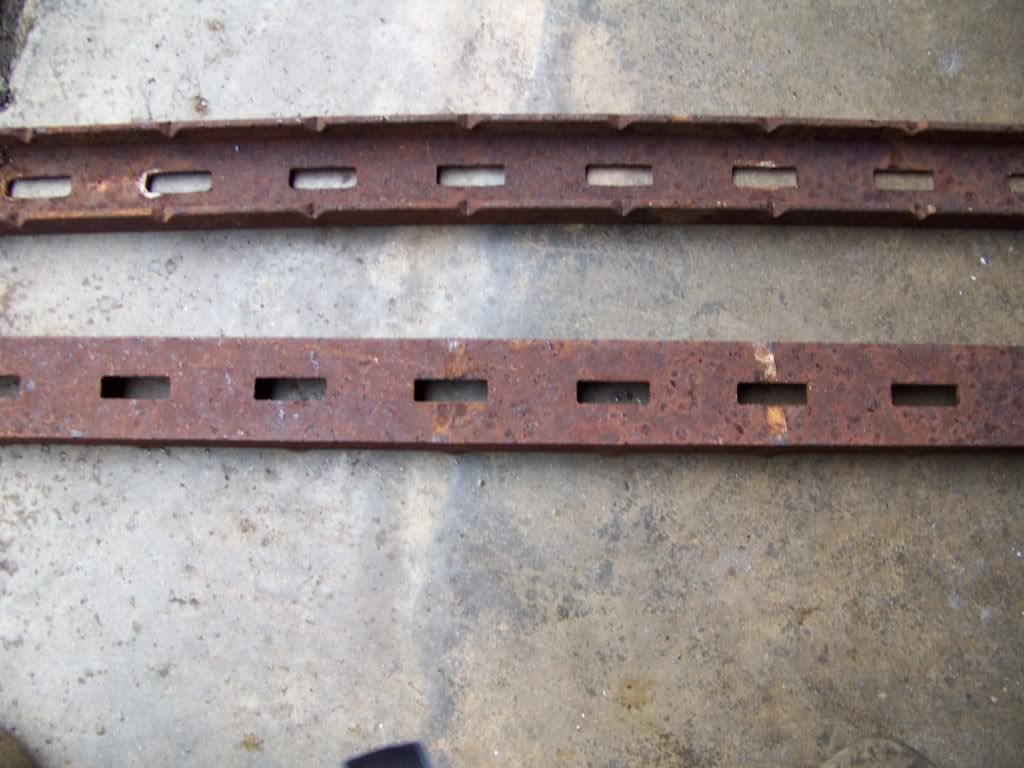

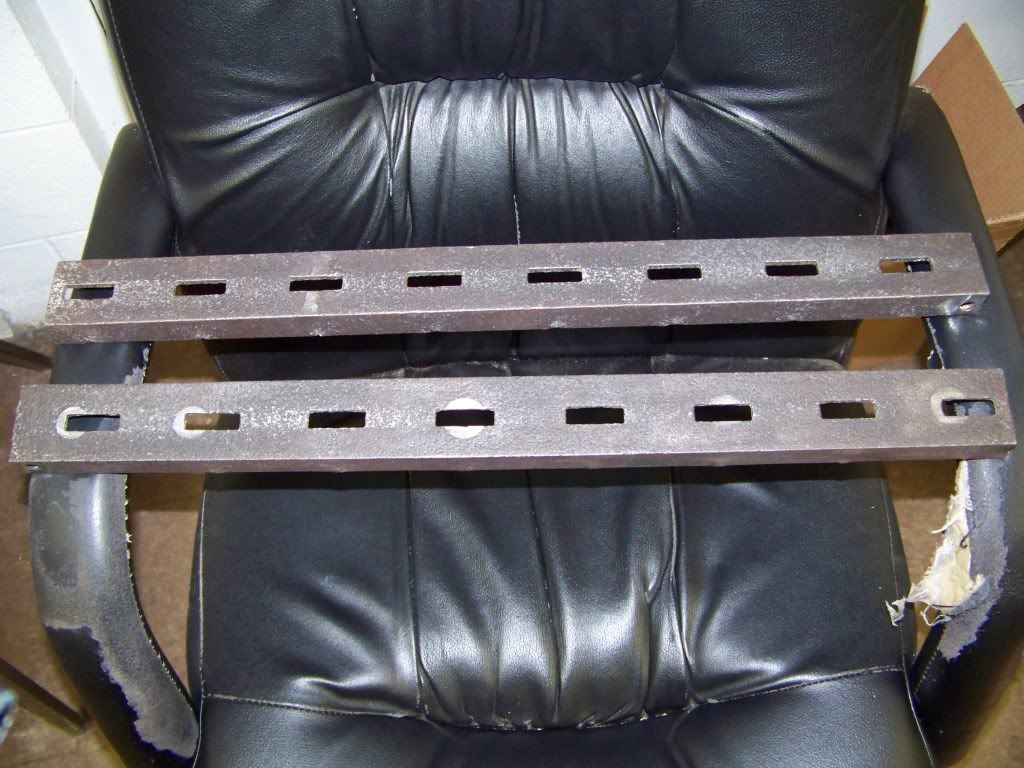

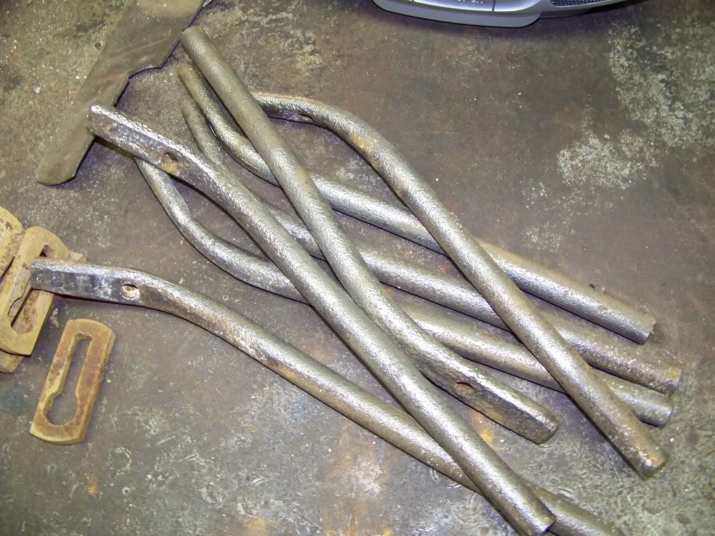

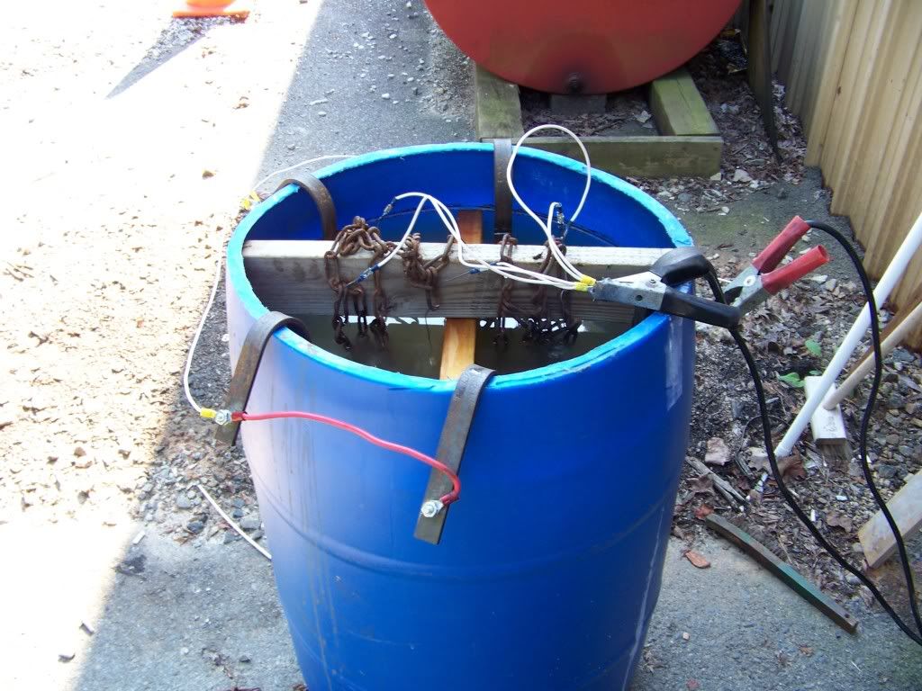

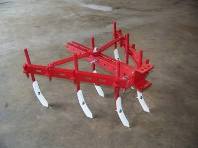

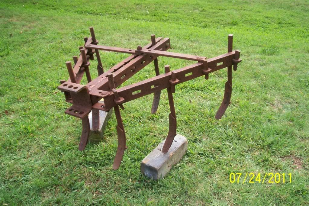

Picked up a Brinley Cultivator for $25 and broke it down and used a sandblaster, e-tank and molasses bath on different parts to test each for effectiveness and how long it would take to arrive at the same results. I mixed 1 part molasses to 10 parts water and soaked parts for around a month, then sandlbasted other parts and used the e-tank for others. Each process ended witht he same results, all rust removed and pratically ready for paint. The down fall to the molasses and the e-tank is the time it took to remove the rust. Molasses up to a month, e-tank a few days and sandblast was right a way. Here are some pics of what I started with and a few of the process and end results. I hope you all can share any results you have had with any rust removal process
Here is what I started with
Molasses bath and e-tank
Parts after molasses bath
Parts after e-tank
Finished Prduct :laughingteeth:

I've never heard of the Molasses process!! Pretty slow though. If you've got the gear then sandblasting is probably still the best alternative but the etank can be very useful and is cheap to set up.

Looks great, I really like how well mine works. I need to make some more clamps, wedges, and rods. I would like to try some different sweeps too.
I've used an e-tank and like that method. I don't have an enclosed sand blaster, so I try to avoid sand blasting.

:welcometogttalk: & Thanks for posting. I haven't used any of those and can't say as I've heard of the Molasses process either. My simple process has been...ordinary household vinegar. Doesn't take a month to soak, involves a bit of elbow grease w/ wire brush, steel wool or repurposed balled up aluminum foil. I've experienced pretty good results in short time.

I have heard of the molasses bath! But I love my e-tank! No sand blaster!

I don't have the volume to do sandblasting with my air compressor. It's not always convenient to run up to the farm for little stuff. I just put it in the etank & work on the next thing.
Last summer, I was working on two implements at once, cooking, brushing and painting all at the same time... kind of had a slow rhythm to it, once i got used to the process. Little bit every evening when I got home from work.
