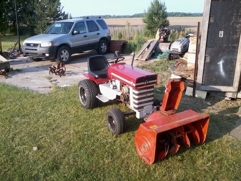

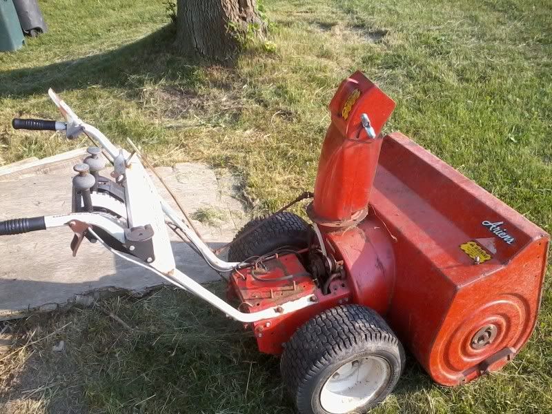

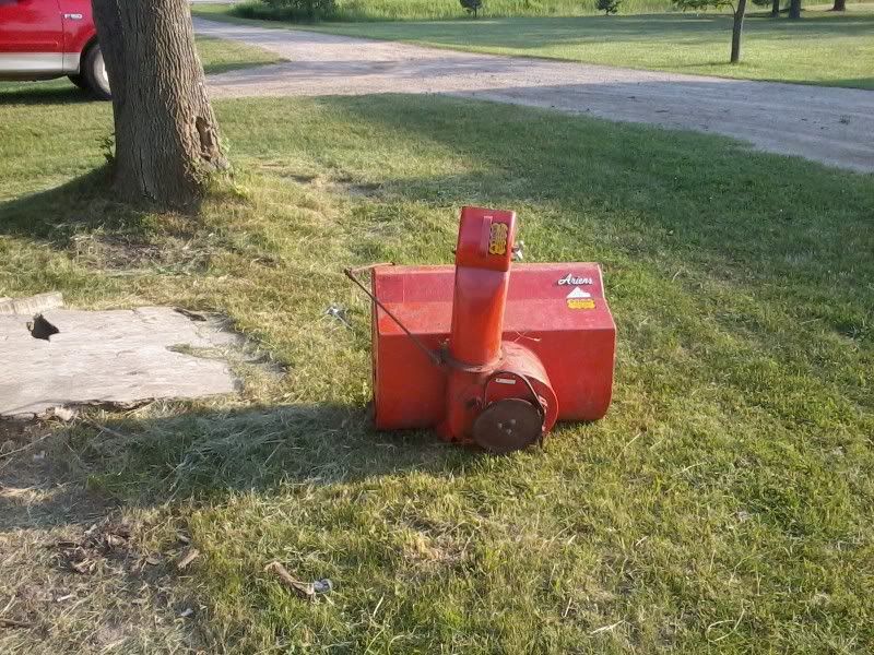

Well a couple of a years ago the connecting rod in the teccy on our Ariens snowblower decided to vacate the premises, so the big blower has been sitting in the weeds for a while now. I decided today to see what it would take to graft it onto the front end of my MF10. Doesnt look like it will be real hard to do, ill let the pics do the talking i guess lol. Any ideas let me know.
Im thinking of mounting a right angle drive gearbox with an electric clutch on the front of the massey, that way its there for anything else I may want to drive off the front.

Looks like it could work. One question, is the blower wide enough to cover the wheels on the 10? Those Ariens blowers are really well built. I have a newish one that has the same cast iron auger drive gearbox as is used on the tractor mount blowers. You might be able to recycle an angle drive from a mower deck.

Looks like you can make it work.Just a bit of advice before you start and get into it to deep just make sure that you have the proper rotation of your input shaft so that the blower will be turning in the proper direction.Another thing is the proper input RPM .Larry

Good points Larry, RPM did cross my mind, but proper rotation had not. Ill have to look into that.
The blower just barely covers the width of the tractor. It looked alot wider when it was a walk behind lol
