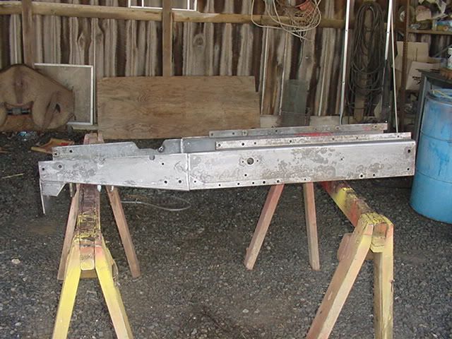

Well, the frame is ready for paint prep work.
