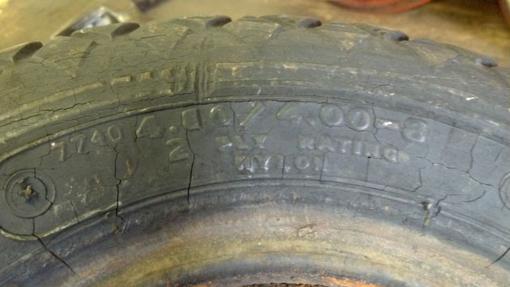

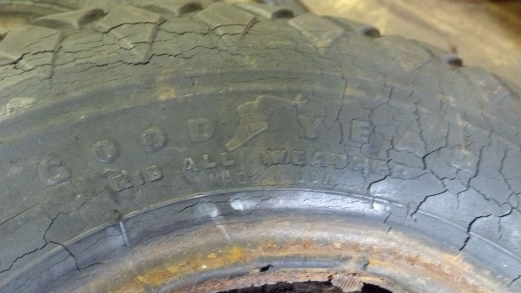

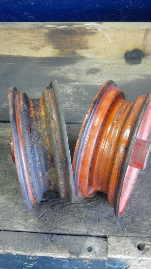

I dismounted the tires. One wheel is pretty clean, the other has some quite a bit of rust on it.

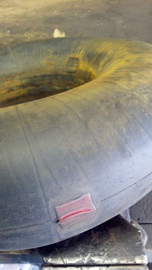

One tube has a patch on it, it looks like a quality patch job. The other tube has two patches on it, they look like they are from some kind of do it yourself patch kit. Both of the valves were crooked and they are pretty messed up. Here is the one with the two patches. One is red, the other is black directly above the red patch in the back of the tube.
Here is the tire size: 4.80/4.00-8
I assume this is the tread pattern? It says "rib all weather" I did a quick search but I only found car tires.

Looks like a hot patch to me. I haven't seen one in years.

You could use electrolysis to clean that rim up real nice. If you reuse the tubes I would not mess with the patches. Good luck finding tires for it. Looks like a neat little trailer.

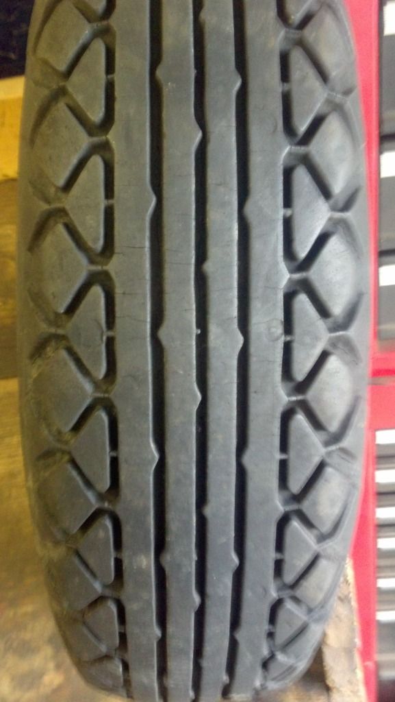

Here is the tire tread, maybe somebody will recognize it.

Good to see you're making headway Ryan, as mentioned above, the etank will cure most of that rim's problems.

I just read Daniel's article about E-tanks. Seems pretty easy and I think I will give it a try.

If you guys think this will work, this is what I will do. A piece of angle iron as the anode and the wheels have a piece of round bar through a hole in each wheel. The wheels stick out the top about 3 inches. I don't see how to submerge them all the way, do connect the charger directly to the wheel after it is under the water? I don't know, but that sounds bad to me.

The wheel should be completely submerged or you will have to turn it over and repeat. You could support the wheels with wire through the valve stem hole. I have not tried it but have read up on it alot. I will be using the process on my winch mount once my shoulder heels enough to remove it from the GT.
