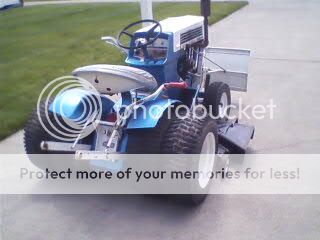

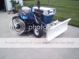

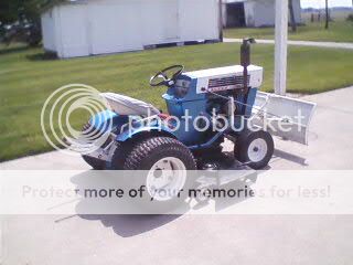

Posted May 23, 2012 - 09:28 AM
They aren't terribly big, but if you want pictures, you got 'em.

Posted May 23, 2012 - 11:31 AM
Nice looking rig. Deck, Blade, Duals. Great condition too.

Posted May 23, 2012 - 11:44 AM
I think so too. If it is as good in real life as it looks in the pics it will definitely be coming home with me.
