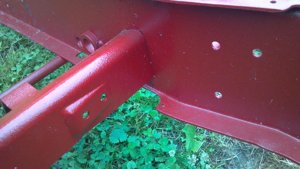

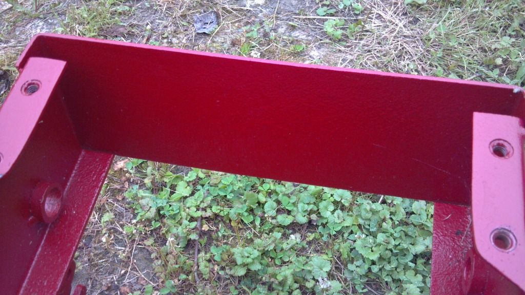

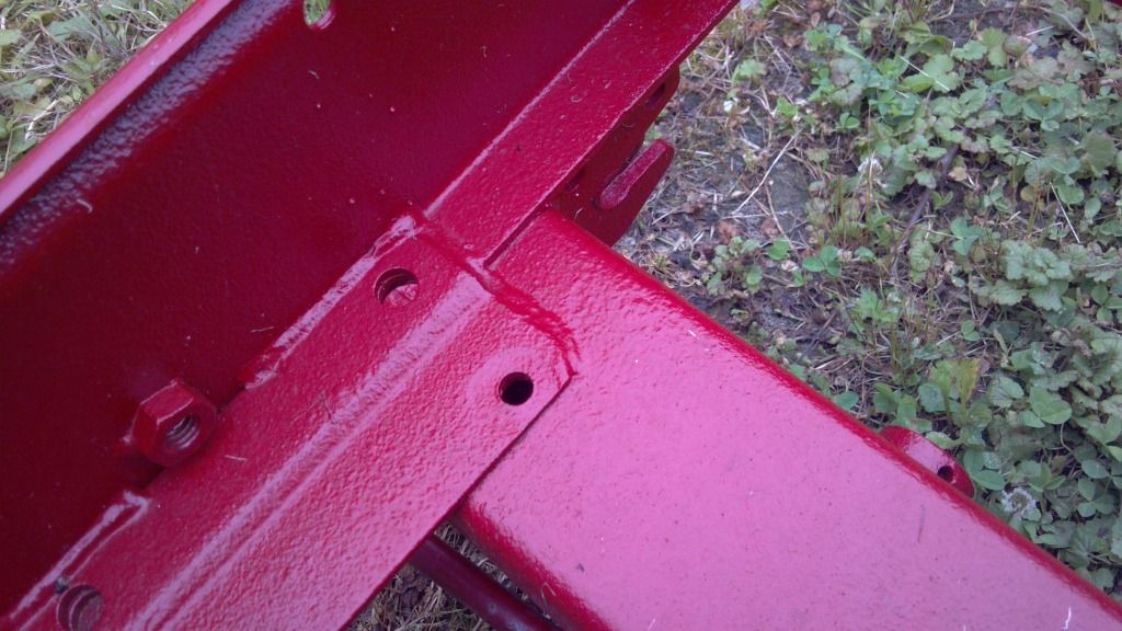

I used 3m chip gaurd inside my frames. Gives it an old school textured look prime and paint right over it. Iv had a wide frame sitting outside for 2 years in the weather and no sighn of rust blistering threw. Iv also done this on front axles and rear ends looks like a factory textured metal after painted

Posted September 15, 2012 - 07:19 PM
dont mind the dirt its been outside for some time and i pulled the rearend out of this frame, what do u guys think?
