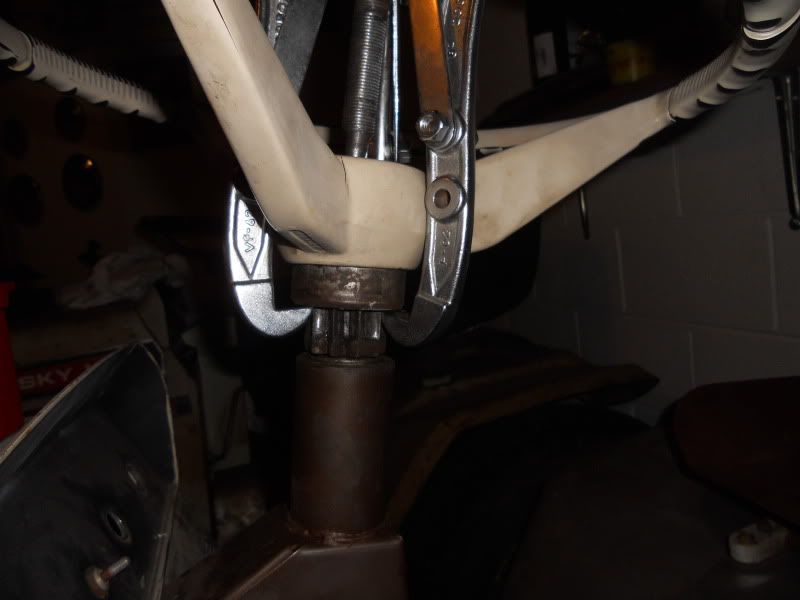

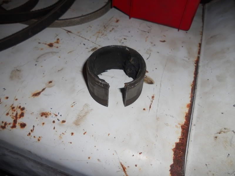

First you need to remove the cotter pin on the lower steering shaft so you can raise the steering wheel up. This will allow you to slid a spacer under the steering wheel.
Make sure the spacer fits inside the bottom the the wheel. Then install a puller and remove.

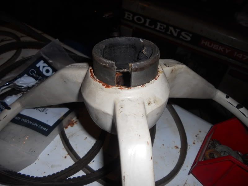

Steering wheel off. Notice the spacer is inside the bottom of the wheel.
That's a great method! This will really help people being that you included pictures. :thumbs:

Your very welcome. I damaged a few wheels myself before I used this method. My spacer is an old bushing from my car. I think the thicker the tubing the better because some of these steering wheels can though to remove. The puller could easly strech "exhaust tubing".
