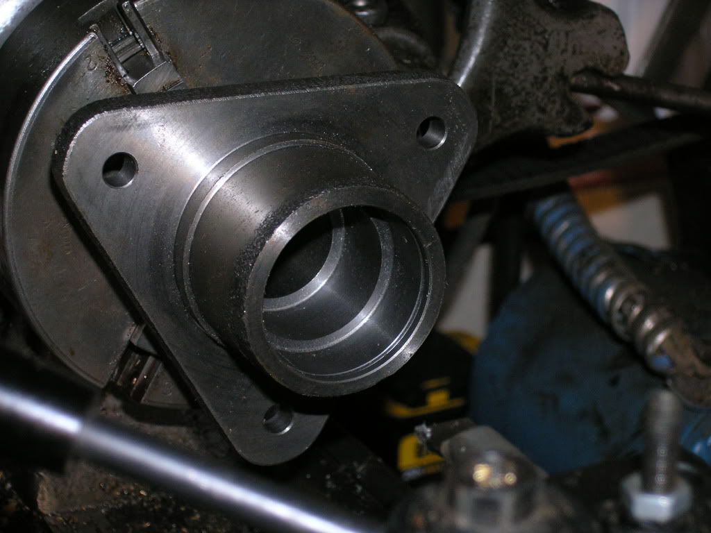

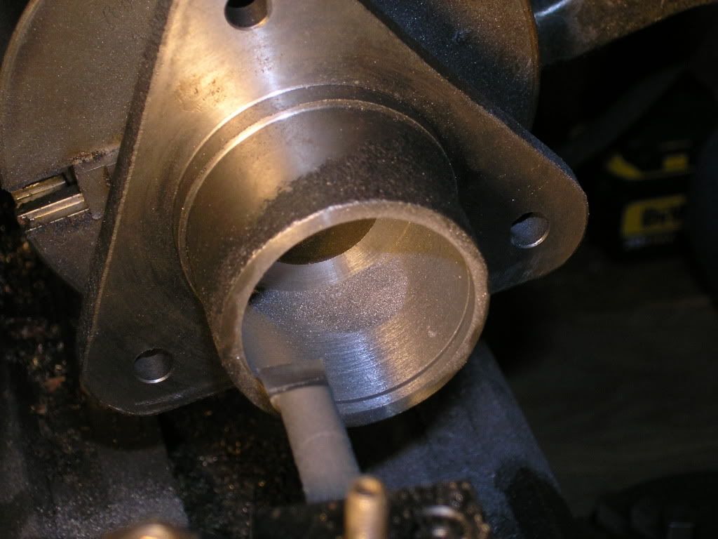

Got the new part and set it up in the lathe.
bored it out and cut a new snap ring groove

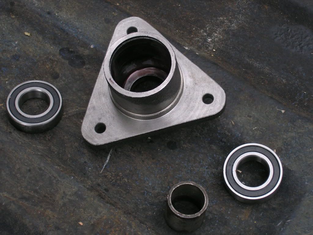

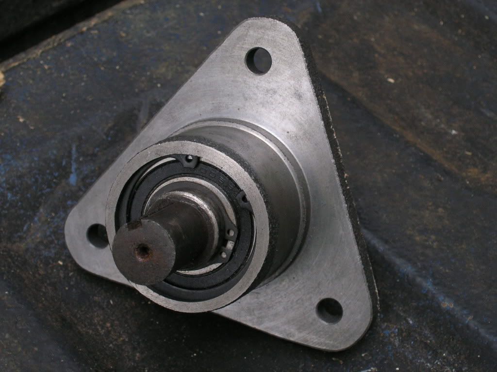

two 6005-2Rs sealed bearings and a spacer
and voila!
Sunday past she cut lawn for the first time in a while ;-)
