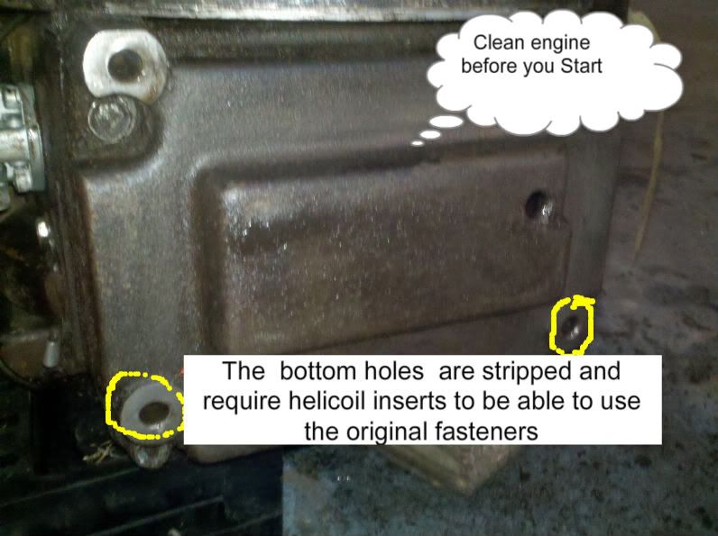

Casey... a couple things...First saying the hydrive isn't to bad is like saying Vince Lombardi is a football coach. Second, if you get the tools that tractor can be completely disassembled in a Saturday afternoon, then reassembled Sunday. They aren't real complex, and with good amount of energy you can do it... So take some of the proceeds from the sale of your 444 put it away, then set your budget so you allow yourself room and time to enjoy your 222, Who knows maybe you'll find a nice trailer, or new plow, or some other implement that will make the tractor real nice to use.
Now for that 'rattle' that is drivin ya nuts. take off the non essential stuff Hood, Seat, Then start the tractor, did the rattle go away? If not get a couple of people relatives, friends and start the tractor have them listen too...if that still doesn't yield any results...start at the front and put wrenches on each fastener, whatever it is will surface...
I have seen, on the 224's not my 222 but you may want to look at the very bottom of the motor where the motor mounts bolt up. I have had to helicoil 2 of them now because when they came loose the previous owners never tried to fix em and just drove the tractors...
Here is my 'write up' on it...better yet this is the first pic...if you need the rest of the write up I will start a thread here for ya...
this will give you some idea, ...don't be intimidated this is not a tough repair and really simple...when you're done you will say 'that was not to difficult'...
