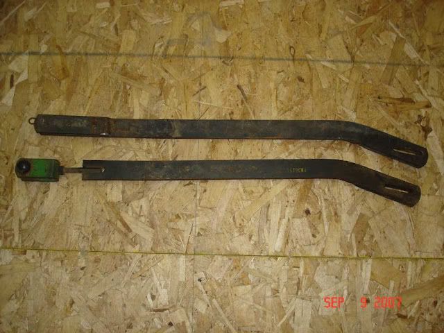

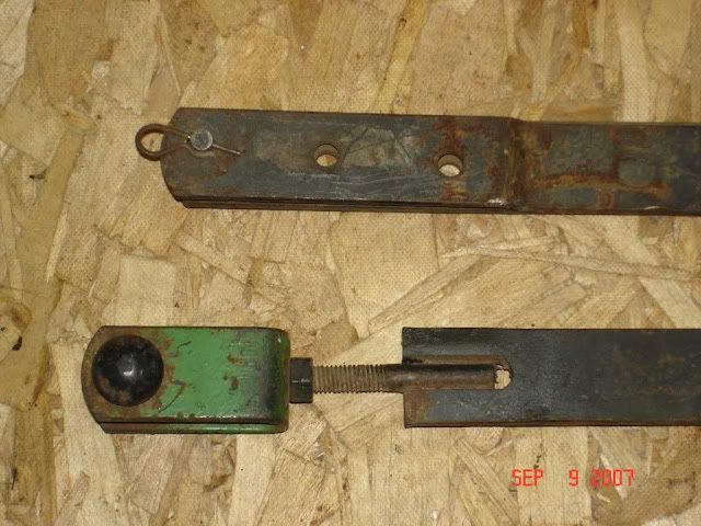

Lets see if I can figure out how to attach pictures here...
Top one is the tiller bottom is for a sleave hitch...

Thanks for the pictures, I thought there was a difference, but was told that they were the same.

When I bought mine the dealer only had one available for both it was the top one in your picture,I found the other one on ebay for 30.00 so I had to buy it.

It looks like the bottom one could be adjusted back to match the top one with the pin where it is in the picture. Too bad they couldn't have designed the tiller to use the same lift as the sleeve hitch. I wonder if you could fab 1 to do both jobs. It would make changing implements a lot easier.

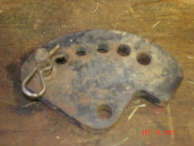

I have seen guys use the tiller lift link for the sleeve hitch but when you do that you lose a adjustment for the sleeve hitch.
Also there is a piece missing on the tiller lift bar pictured. It is like a cam with different holes in it that controls how deep the tiller goes into the ground.
Mark
Mark
Well I made one without the cam thingy, Mark, do you have another photo of that piece? Thanks...

I will try and get a photo this afternoon. :smile1:

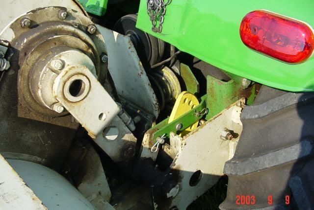

The missing part is the cam. Just a couple pictures I had on the computer...

Yep thats it LOL
