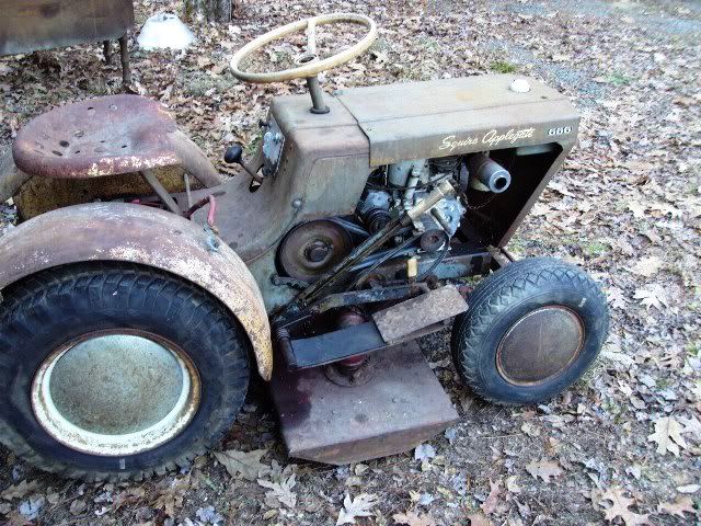

Nice looking GT you have there. It seems that Lambert and Farmette were related or one bought out the other at some point. Both Google search and searches here have alluded to this.
Here is another pic of a members lambert with a different badging on it.
If you look thru the great manuals in the Farmette area, you will see an almost identical looking tractor.
http://gardentractor.../152-farm-ette/
Can you tell the original color?

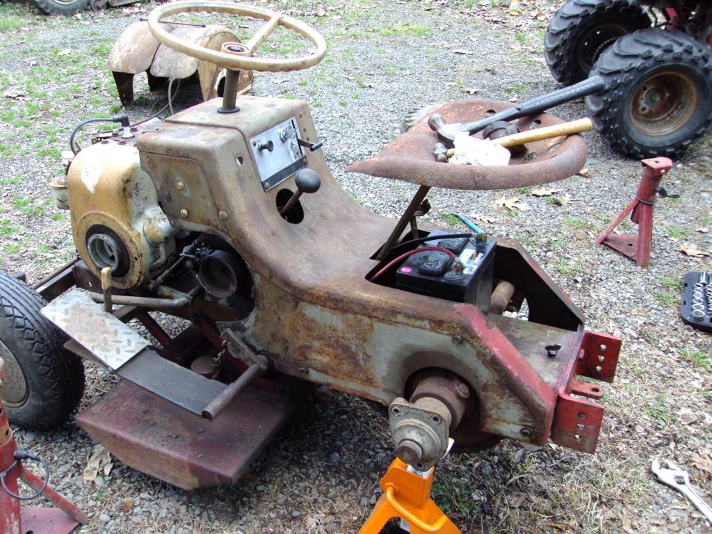

Your tractor could be a Farm-ette model 650. Without knowing the original engine size will keep you guessing.
One thing you can check that may shed some light. If it is in fact a Lambert (1964) You should see at least 3 holes in the rear deck where the fenders would mount.
Not sure if you can see the bolts are still mounted after I have removed the fenders. Hope it helps.
