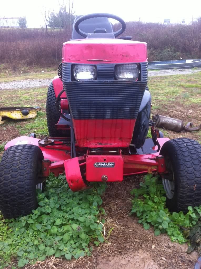

Ive had tons of wheel horses ranging from RJs to D series. Took this in on trade. Guy said the pic up coil was bad. Hopefully hes right. I suppose this will be the next project after the allis.

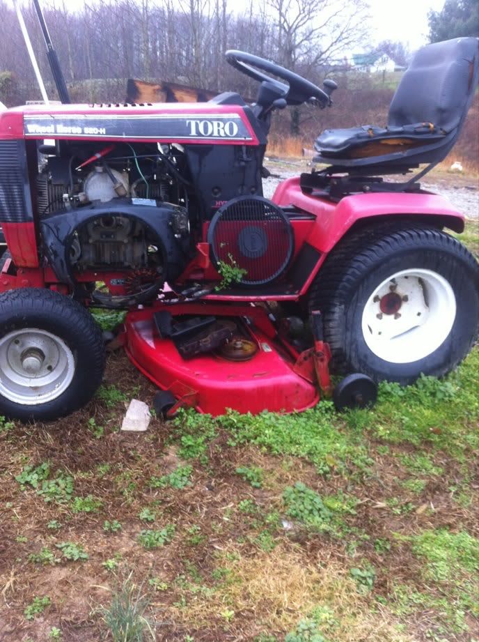

I know some of these had the bigger front end. If you can tell by looking let me know, if not ill measure tomorrow when it gets here.

It appears from the side shot that it has the swept forward front axle. If it does, you can run the 60" mower deck. Those are very nice Heavy Duty tractors, always wanted one, just was never in the right place at the right time. Good Luck..

Finally got her home. Looks to be in about the shape I thought. It does have the front sweep axle. No hitch and is missing the cover that goes between your legs. Hopefully i can get it all back together. The ol WH horse will have to wait until I get the allis done. Here are a few pictures. If you see anything overly wrong let me know.
