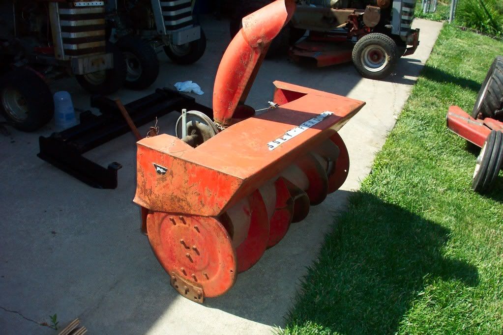

Well, Thursday morning at 5 AM I headed out on my journey. I stopped in Luverne, MN to sell the MF720 snowblower to jrwox. I see we have a new member from the meeting. I hope the members with MF7-8 tractors can help him get the blower going again.
I then drove to Brainerd, MN where I acquired a very complete and original 1966 MF10. The serial numbers are very low, tractor #959 and snowblower #516. The rear wheels are rotting off of it from calcium no doubt, but it is in very good shape. I had some time to do some finishing near Blackduck, MN and spend some time with friends. Hopefully someday I will make the journey North and not have to come home.
Pulltilbroke came over tonight and helped me unload the early MF10. We then pulled it out back. I didn't have time for pictures tonight, but the wife took one on the way home yesterday that will have to hold you all over till tomorrow... I'll bet nobody can even guess where this picture was taken, no it isn't Milwaukee.

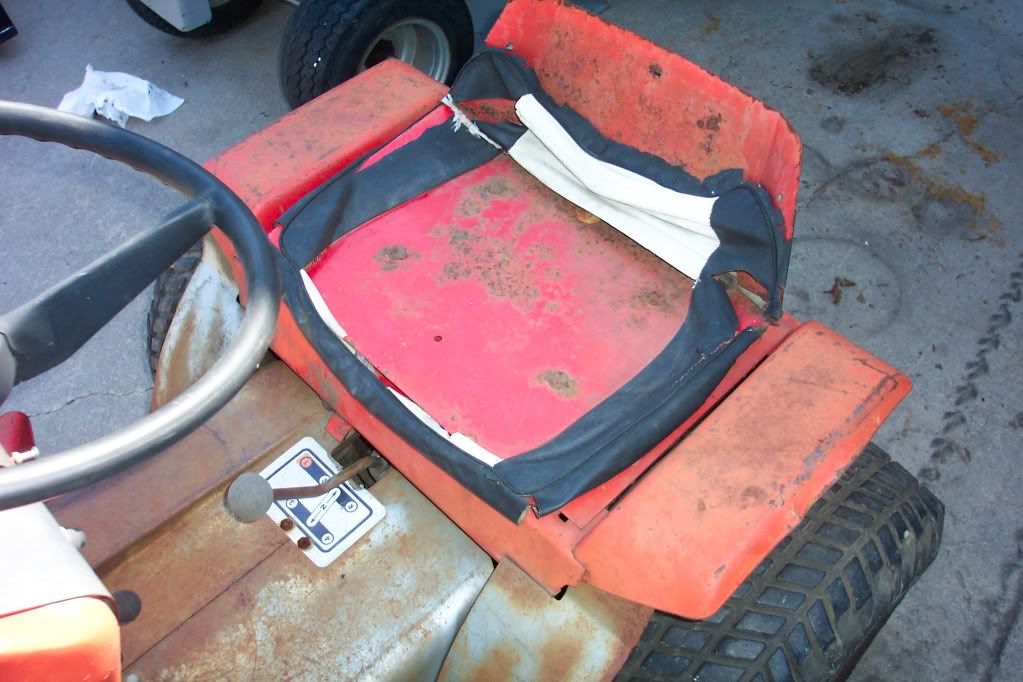

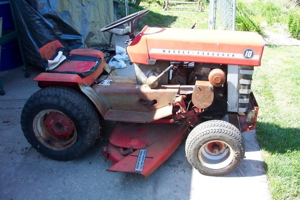

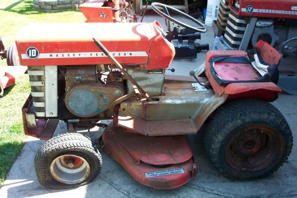

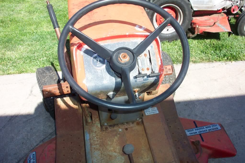

Posted June 09, 2010 - 11:13 PM
I snapped a few pics after I got done mowing.

Those are great pics - congratulations on a nice find! The inspection hole in the right hand side plate looks interesting - did it have a cover over it at one time? That doesn't show in the parts book! The original seat too - that will look very pretty restored.
