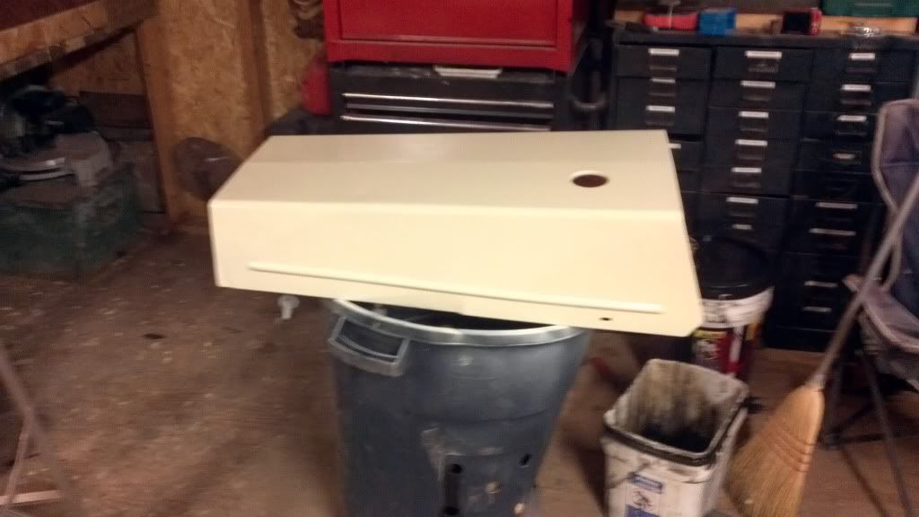

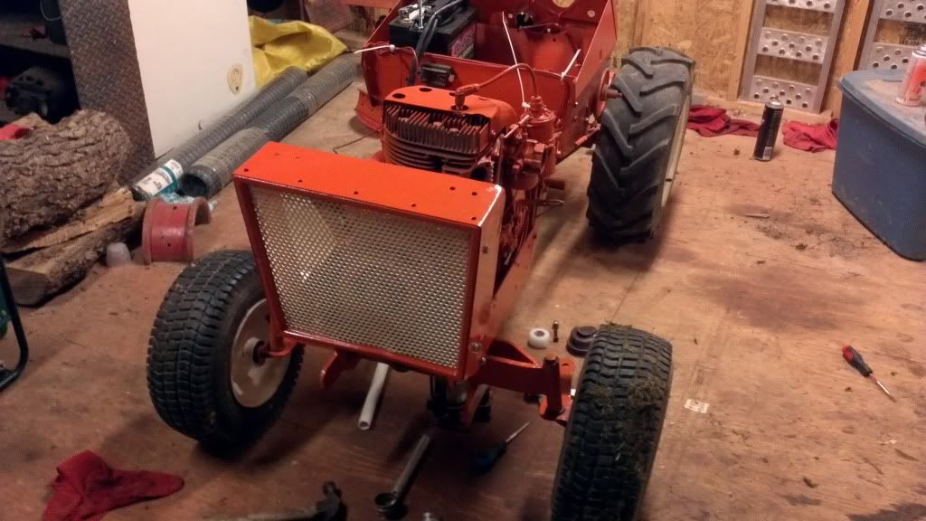

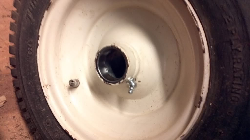

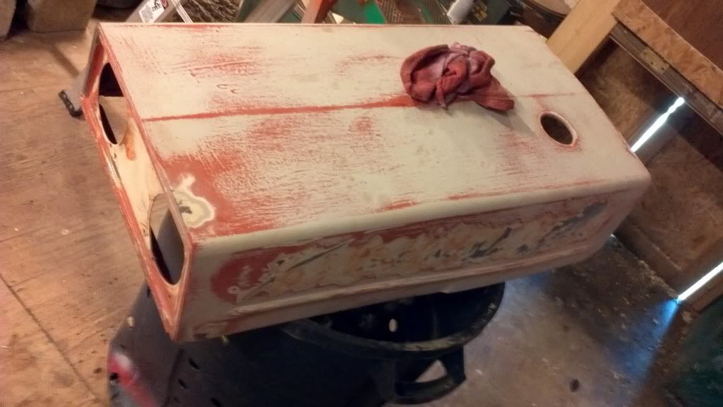

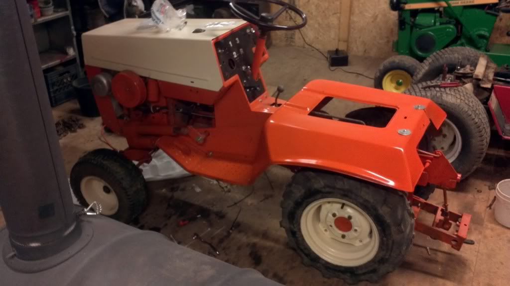

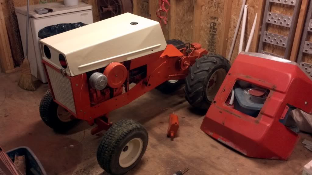

I decided to do a little more today. I added grease fittings tot he front wheels. Seems sad to have such good bearings and no way to grease them without removing the wheels. I also started on the hood. Looked to be several coats of paint. The hood has been orange and white several times over its life.

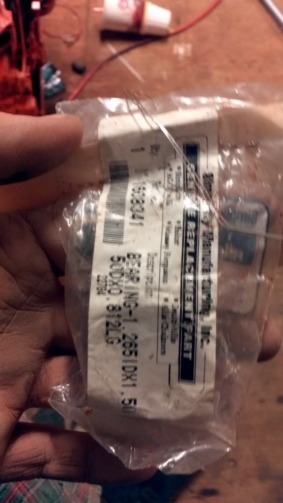

While i was sanding I heard a truck pull up. UPS - brought me this.......yahhhhhhhhhh (the bearing)

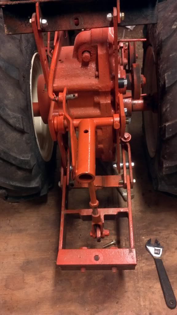

here is where I left her. hopefully it will be running next weekend. Still dont know what im going to do about the damages rear pan and running boards.
#19 Michiganmobileman OFFLINE
Posted January 30, 2012 - 09:21 PM
Good idea on the grease fittings :thumbs:
And I'd say you did real good on the hood, (rest of the tractor too!) how bad is the rear pan and running boards?

Posted February 05, 2012 - 10:37 PM

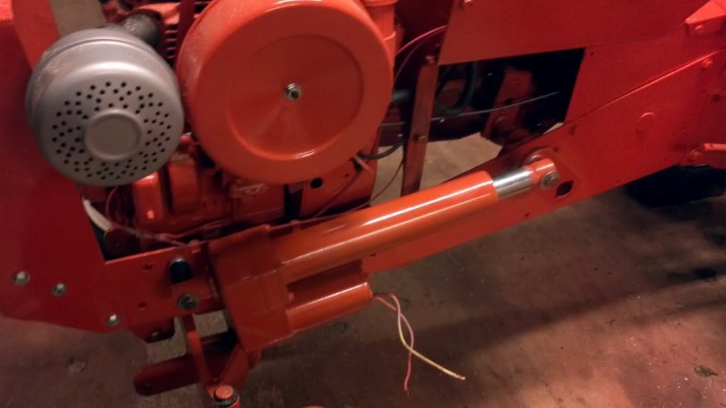

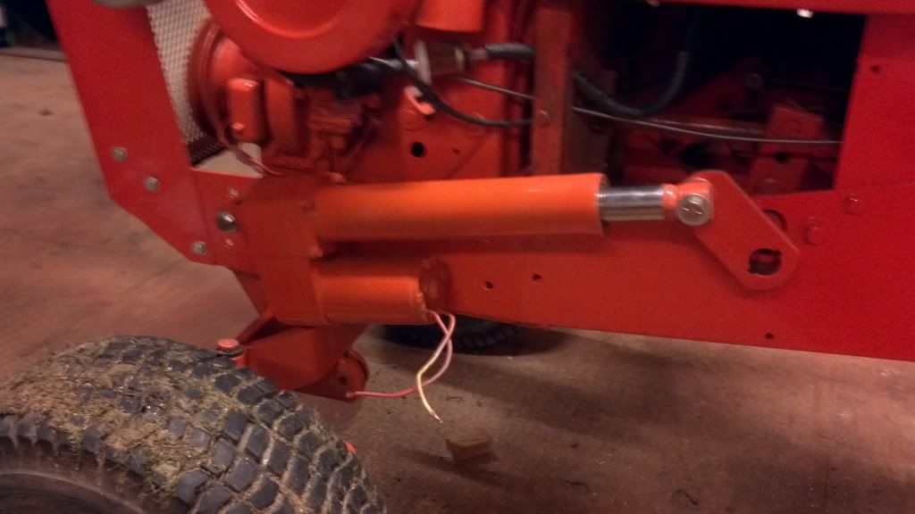

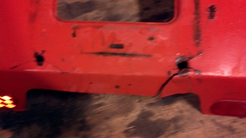

Heres the seat pan. The running boards are worse. I need a welder. Got the hood on and fired it up today to test the wiring. All went well.
Ive got a bad elbow and try to improve on everything i do. Im adding electric lift to this one. Bolted it where the lift handle mounted. Ill have to watch the frame to be sure it doesnt bend.
#21 sammiefish OFFLINE
sammiefish
  • Member No: 7456
  • 8 Thanks
  • 26 posts
Posted February 07, 2012 - 08:07 AM
it seems you have the key where the cigar lighter (12V power outlet to be more politically correct) goes...
i just bought the $4 replacement at the auto parts place....
neat idea on the electric lift mount...
i cant really tell by the picture but does it seem a little close to the front axle...?
meaning, as the axle pivots does it hit the lift gear box?
Edited by sammiefish, February 07, 2012 - 08:12 AM.
#22 BairleaFarm OFFLINE
BairleaFarm
  • Member No: 8328
  • 1,354 Thanks
  • 1,783 posts
Posted February 12, 2012 - 04:15 PM
Its really close to the axle but should clear. I put the ignition in the cigarette lighter hole since it doesnt fit the OEM location(different easier switch) I dont like cutting stuff up just to make it fit.
#23 BairleaFarm OFFLINE
BairleaFarm
  • Member No: 8328
  • 1,354 Thanks
  • 1,783 posts
Posted February 13, 2012 - 08:37 PM

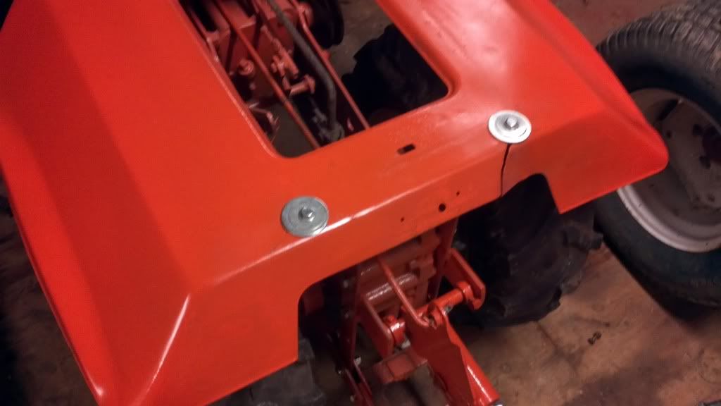

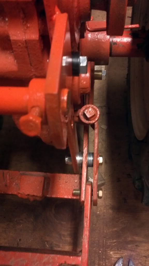

In these pics you can see my "fix" for the seat pan. It will work for now. I threw a quick coat of paint on the pan and the running boards until I figure what im going to do with them. I also got the hitch mounted. Either its pieced together or something is bent or it was installed incorrectly to begin with. I had to use some spacers to get it to fit right.

Looks good enough to me David! You may run up on a better pan anyway. What's wrong with the running boards?

rusted out on the mounting tabs and twisted. I saw some on ebay but shipping would have killed me. I may one day have access to a shop and be able to fix the pan.
#26 Michiganmobileman OFFLINE
Posted February 13, 2012 - 09:04 PM
I think there is usually spacers where you have the washers at. Do you have a parts manual?

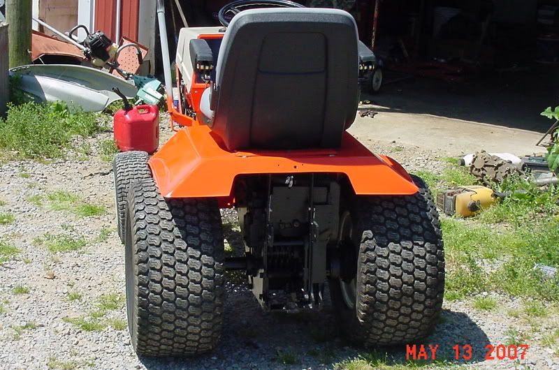

Fair warning to you David, these tractors narrow wheelbase make them mighty tippy on sidling areas. That's why I got some wide 24x12x12 turfs & wide rims, then relocated the rim center so they would clear inside. Made a HUGE difference in stability. Before it was dangerous on any kind of a slope.
