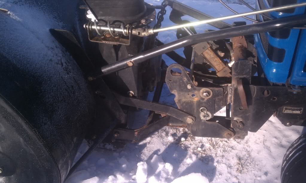

Well driveshaft is starting to come together real nice, all I need to do is install the yoke on the box and then assemble the cross and shaft to it.
Here are a few shots of the afore mentioned parts..

Posted January 19, 2012 - 04:37 AM
Well got it all assembled last night, works great with out any binding at full lift.
And the connection at the tractor, hard place to get picture of...
It's ready to go now, I wd'd everything up on the shute so it should be good to go.
