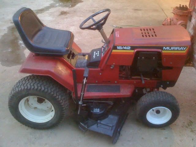

Oh and I finally figured out how to remove the battery from behind the Steering column.1 bolt and the whole column pulls out.Simple but Why did they put it back behind the column?I have no idea.
Mine has the same set up. With mine, after loosening one wing nut a few turns you can remove the battery hold down bracket and the battery will then slide right out. Shortly afterwards, Murray moved it to the bottom of the dash, with a plastic access cover. It can be seen here, it's the black piece with the shift pattern written on it. Honestly though, I don't think this set up is much better.

That's a nice looking GT.Those Twins are power houses.
I wonder if they used the same goofy cut down crank and pulley setup on those to?
The crank is turned down on the end and the pulley slides up on it only about 1 1/2 to 2 inches and it has a very small woodruff key.It looks like it would be a problem if I ever decide to work it hard with the plow or towing firewood logs out of the woods.
