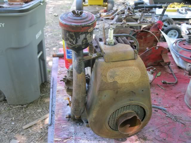

Here are some photos of the DB Basket Case. I could find no markings on the motor. It is not frozen anymore, atf and diesel fuel works wonders for freeing up stuck things.
I found the pins that hold the back of the cover on. The cover will not clear the recoil starter on the motor as it sits now. I guess the cover is a little rustier than I first thought. Any idea what this motor is? Well enjoy the picts. Going to shovel some snow now.

Can you check the model number again? It has the 1950 and later motor mount. The slots on the mount are angled from the bottom up, the 5751 the front slots are straight. It also appears to have the 1950 and later spring clutch on it. The pulley on the 5751 was steal this one is alunimun.
Also the motor looks like a B&S.

Then somewhere along the line someone has changed the motor mount, and the clutch, or the transmission. The setup you have would have found on either the 5752 or the 5756. The only difference between these two would have the motor. The motor on yours has been replaced.
The 5751, and the 5752, the motor would looked like this one.
This is an early Model 8 Briggs but the Model N and Model 6 would have looked just like it.
