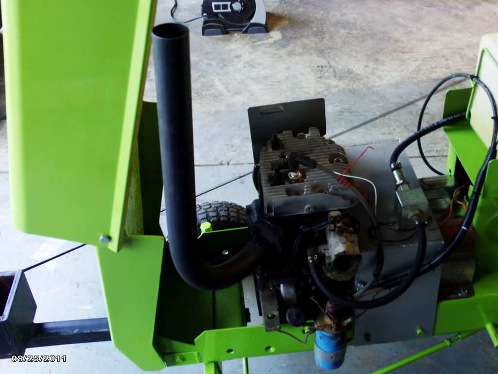

No I dont need a regulator,since my fuel tank sits above the pump and carb,its works pretty well.My fuel tank is a radiator overflow tank and sits where the battery was from the factory.I will post a pic of it if i can find it.may help you out some.This is my tractor....Mama Tried.

BTW nice looking tractor.
