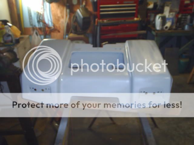

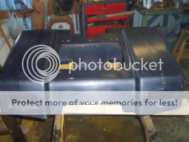

Well I haven't gotten to work on the 109 as much as I would like to, but I have made a little progress.In the first to pictures I have sprayed Rust Reformer/Sealer and wet sanded:

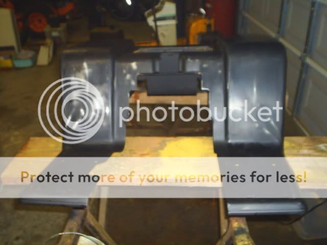

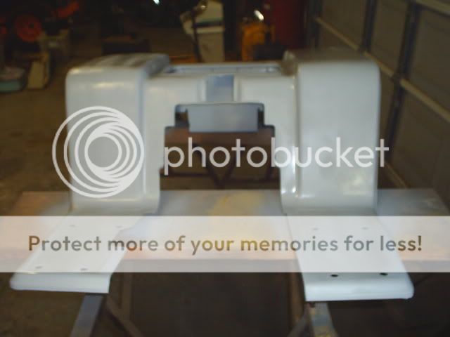

Then I sprayed Light Gray Primer and will wet sand and repeat until its as smooth as a babys behind.

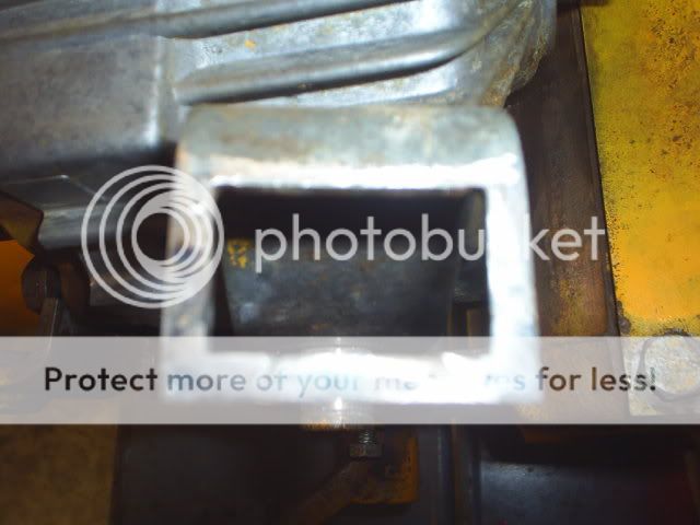

This morning I repaired the trunion bracket. It had the usual wear grooves in the outside corners so I welded them up and filed the corners square again:
