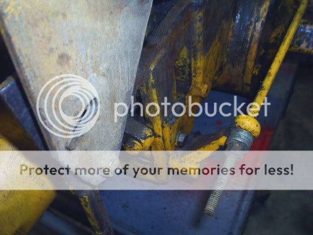

Tinkered with the 109 a little more today.
Got the fenders off. Here's a look at the bottom side:
Looks like I'm gonna need to reline the brake pads too! I think I saw a how-to thread on that around here somewhere.

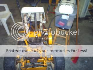

It's been a few days since I've had a chance to have some more fun with my 109, so here's an update:

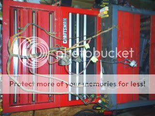

First I yanked the old wiring out of the tractor. It's hard to see in the picture but the insulation was cracked and missing chunks really bad.

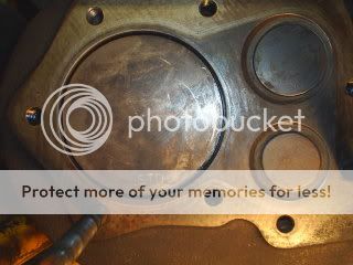

Then I built a new wiring harness and installed it. Next I noticed then the head gasket appeared to be leaking,so I pulled the head and replaced the head gasket. Retorqued the head bolts to 30#.
I noticed while I had the head off that the old K241A still had a standard piston in it.Glad to see that, means I got lots of cylinder wall left for future rebuilds!
Put a new spark plug in it and cleaned-up the points. Set the points by the static method described elsewhere on this site. I hadn't started this tractor since I brought it home, so I attached the V/R to the frame wall and hooked my Harley battery to it. Put some fresh gas in the tank....
IT'S ALIVE!!!!!!!!

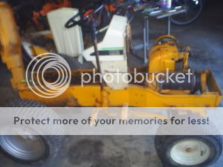

Update: I haven't been able to work on my 109 much lately, but I do have some progress to share with my fellow tractorholics.
Been sanding on a few things:
more to come....

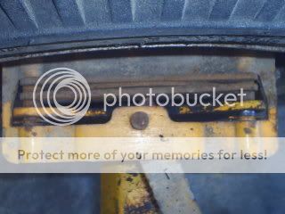

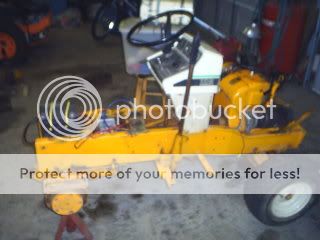

The second picture in the last post also shows the new bottom I welded into the battery box. Then tonite I split the tractor to continue the refurbish.
I noticed I have a bracket broken on the left side:
Right side is good though:
Somebody wouldn't have a bracket laying around would they? (hope,hope) I would rather replace than weld if I can.

Saltydawg I reckon I might have one or two of them floating around in the garage.
