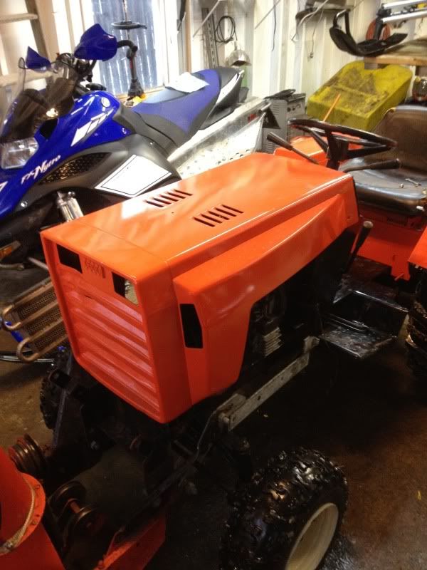

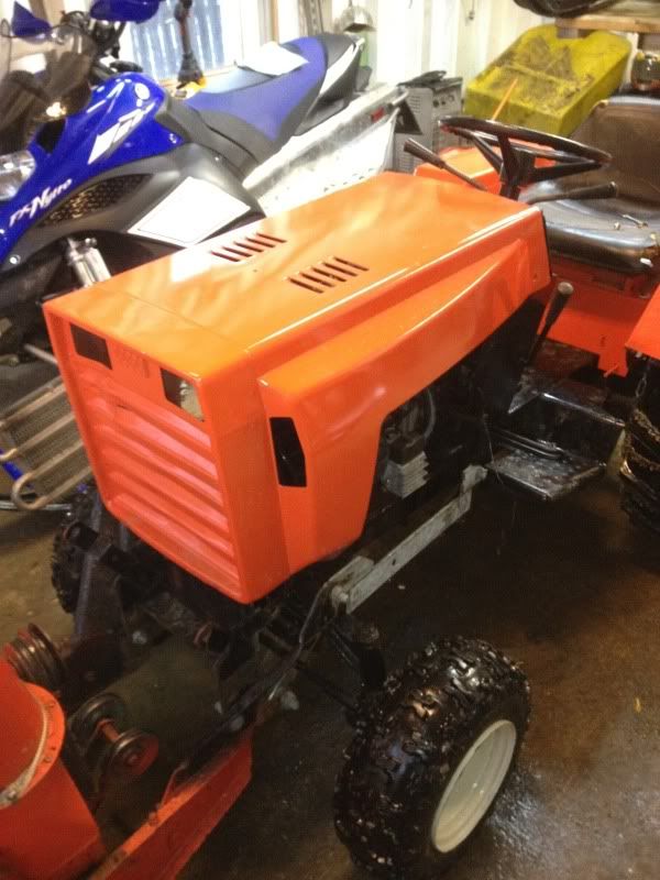

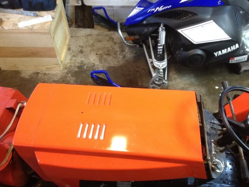

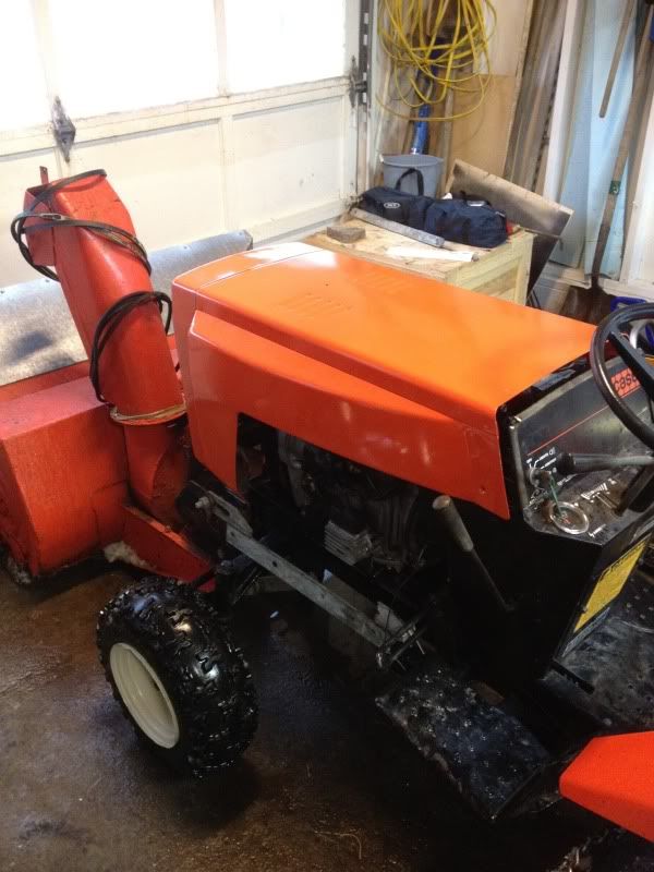

#26 bulldogbones OFFLINE
bulldogbones
  • Member No: 7933
  • 7 Thanks
  • 11 posts
Posted January 01, 2012 - 08:50 PM
THis is what the tractor will look like once I install the hood.
  • MH81 and Cvans have said thanks

Posted January 02, 2012 - 07:35 AM
That side piece reminds me of my Ford closed side panel. Might work to 'widen' a hood.

Posted January 02, 2012 - 09:01 AM
Coming along nicely. Thats a very nice tractor you have there.

Posted January 02, 2012 - 10:26 AM
Looking good Bulldog! Is the hood sitting a couple of inches forward in the pictures due to clearance issues or is it just not properly hinged in this mock-up?
JN

Posted January 03, 2012 - 07:45 PM
Yes the hood is set forward a little bit to clear the fan. But I think I remedy that situation. By cutting the front pto shaft and removing all the Onan clutching engagement stuff and just putting back at fan and an electric pulley clutch like is used to engage a mower deck.
